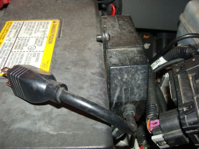

I permanently mounted and wired a Schmacher charger under the hood. I just plug an extension cord into the charger pigtail.
Old Mar 17, 2022 | 09:20 AM
You can tell he is a boater, onboard charger set up and all.
