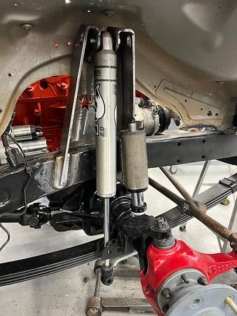

In my case, I couldn't care less about the key fob. I just did this LS6, 6L90E, Dana 300, and Dana 44 conversion, so far I've managed to integrate the ABS, Stability/Traction control, and every other control I can think of, and got the lights off in the dash. But the TPMS keeps lighting up, put multiple sensors in tires, but can't get them to program.....assuming it is due to the antenna poor reception.
Unfortunatly when I got frustrated with it, I took it to my buddies tire store where they installed the Autel brand sensor that they use. They couldn't get the new sensors to program either...... BCM just wouldn't recognize them. They didn't want to charge me for the sensors that didn't work, so they took them back out. Now I have no sensors in the wheels, so I'm trying to get the fob to work, "because everything I've read says they use the same antenna" before I address the TPMS sensors again.
