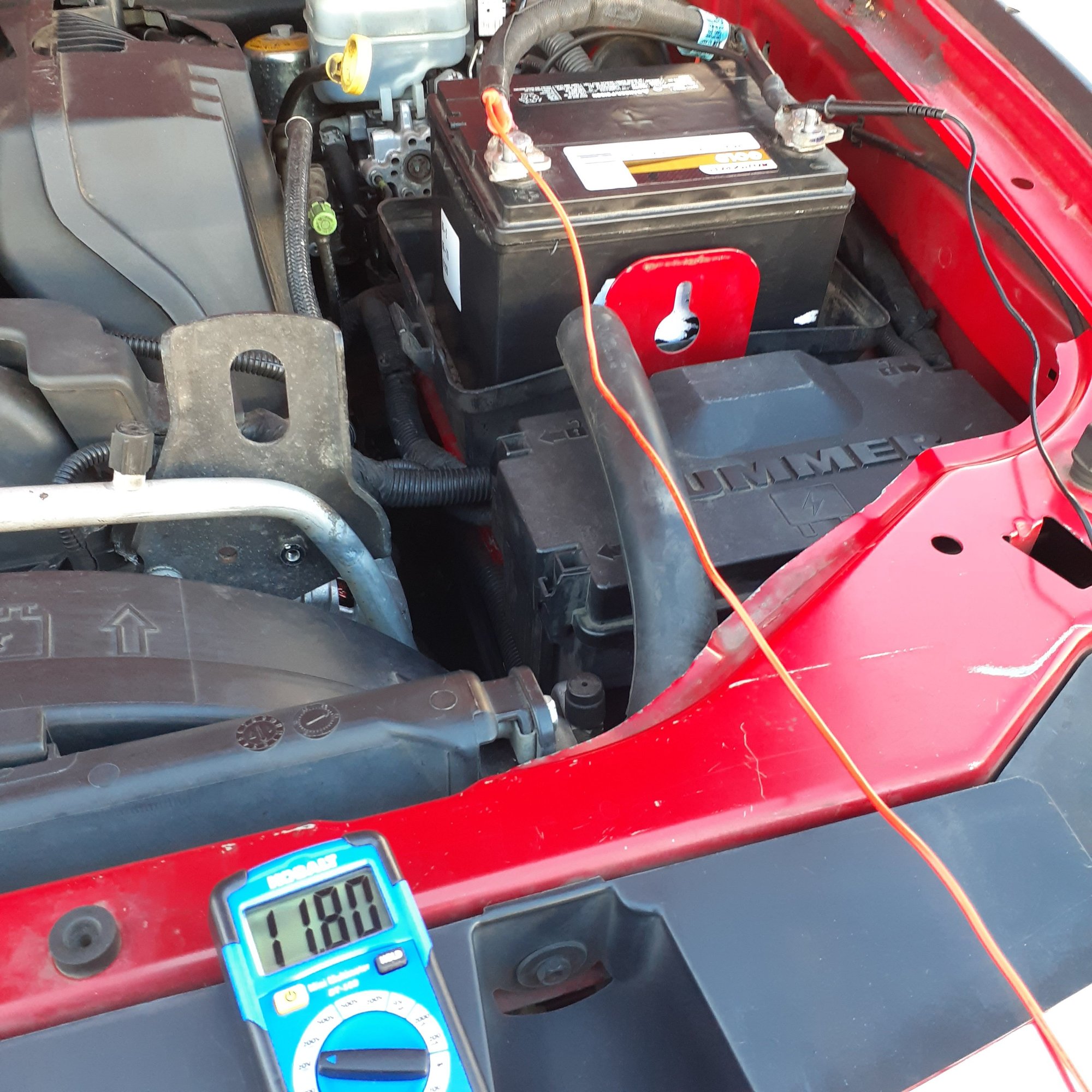

Hey All,
I recently changed out my alternator (thanks to this awesome forum) however my battery died and when tested the alt is only reading 11 volts. I changed the 91 mega fuse however I'm getting no alternator juice. Has anyone ever purchased a bad/ faulty alternator??? I purchased the AC Delco part. I really don't want to install another alternator. Thoughts/sarcasm??? 2006 I5 by the way

You can't get 11 volts with a charged battery.

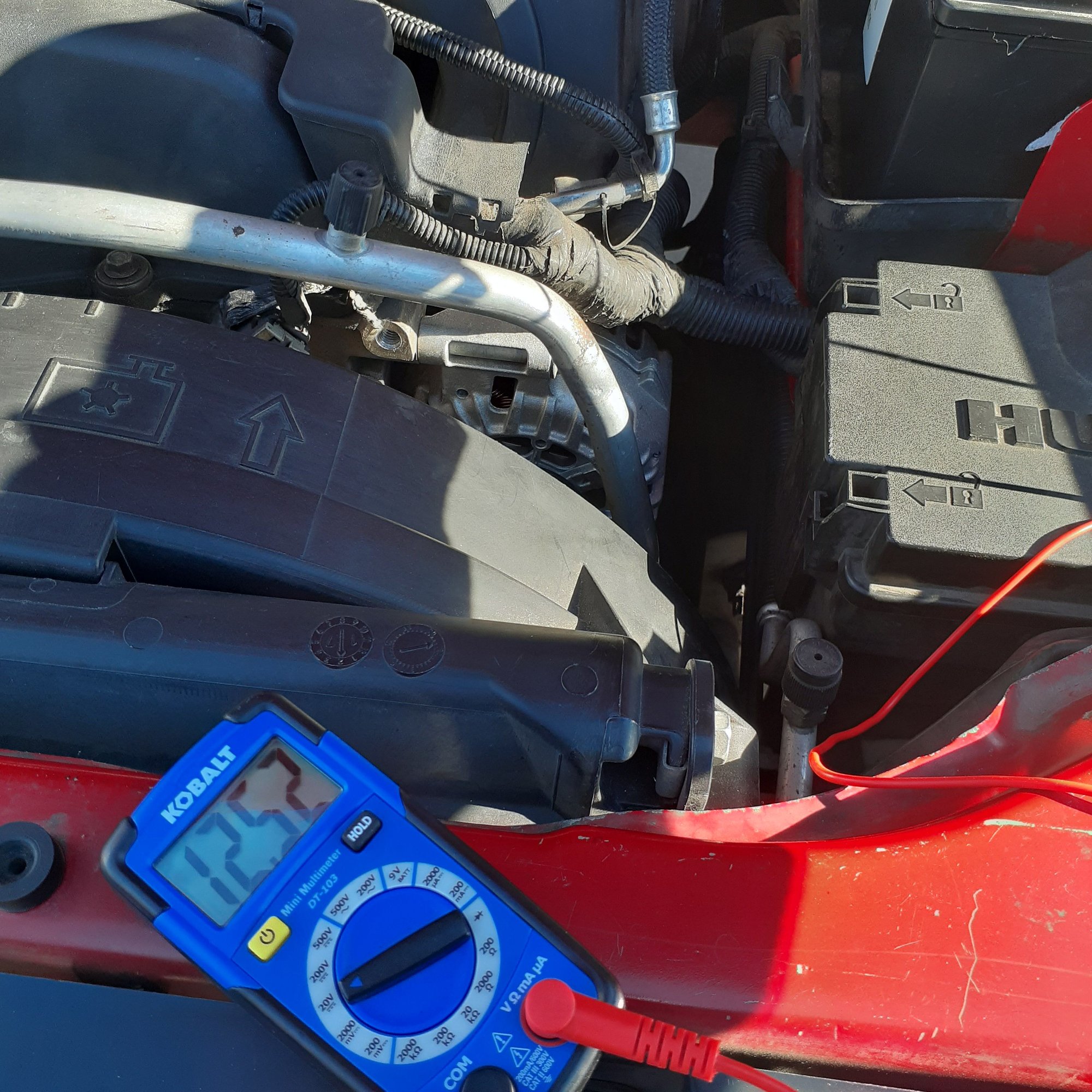

Old Feb 20, 2021 | 09:00 AM
Posts: 9,014
You can startup with 11.8vlts? Fully charge the battery, and put that meter to work, start by checking powers and make sure there is ground at the alternator, check fuse 7, remove fuse 32, test alternator output when battery resting voltage is 12.6+. Btw, new battery terminals should be on your to-do list.

this is with the 32 fuse removed. Looks like I'm cooking with gas now.

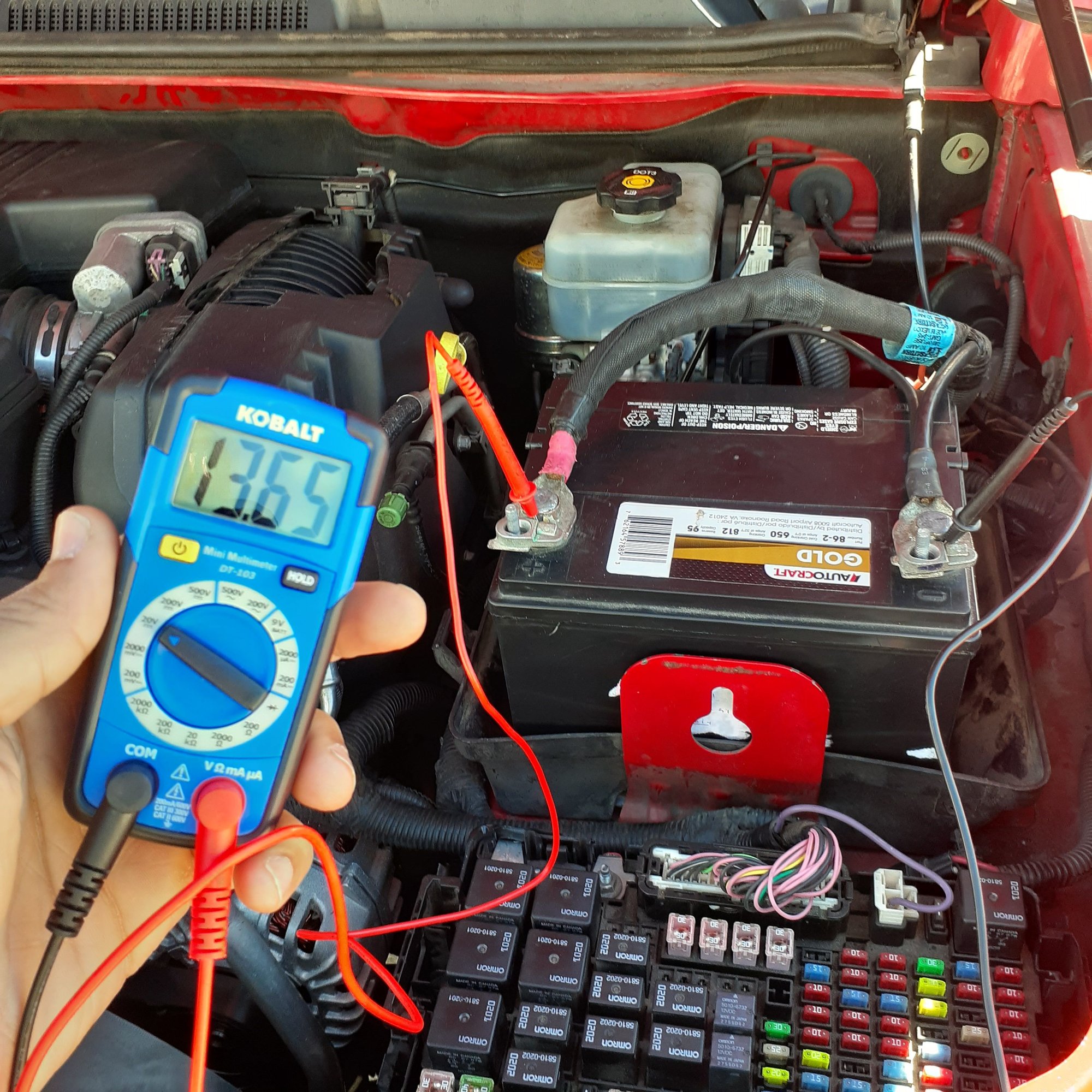

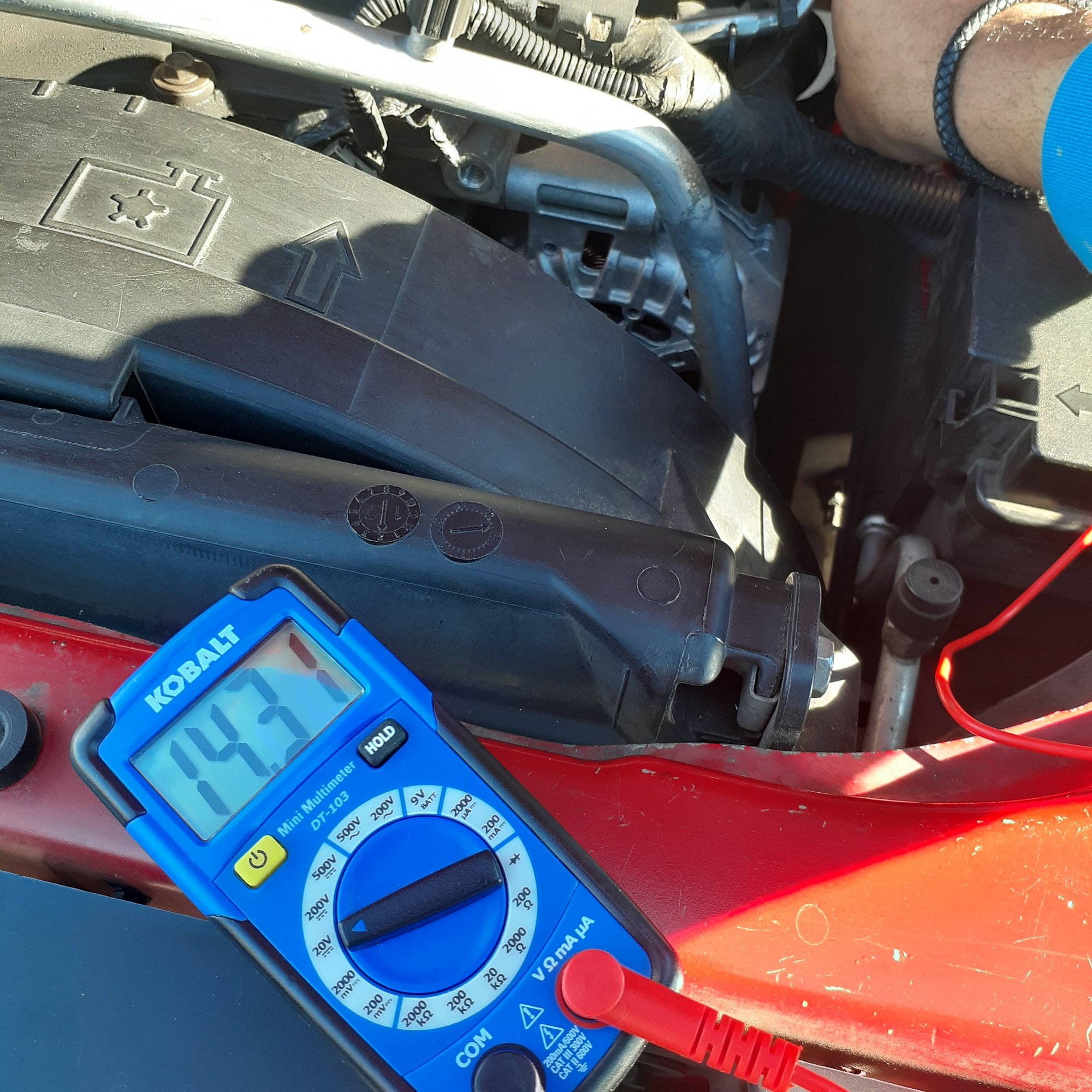

What's the voltage at startup? (probe at the wire under the tape before the terminals) Should be 15v+

Default Multimeter reading
Alternator output.
Behind the terminals.

Posts: 9,014
2v drop?
change those battery terminals, clean/secure/seal wires & recheck!
