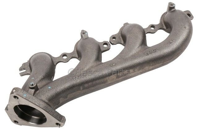

Ebay -
HUMMER H3 5.3 PASSENGER SIDE EXHAUST MANIFOLD 2008-2010 NEW OEM GM 12600527
#1 on Diagram Only-Genuine OE Factory Original Item
Can I really get exhaust manifolds for my H3 Alpha that don't have the Cat? Then I could go with real dual exhausts with no restriction!!! I have given up trying to find headers.

Alpha don't have the cats integrated.

So I can just unbolt the ones I now have?

Yes, leave the manifolds intact.
I think you should take another look under your truck and note the exhaust path.

Alphas don't have the cat attached to the manifold (not a 1 piece item like the 3.5L & 3.7L).

yea, it is tight under there. I'll find a way!

All you need is pipe and a bender.
