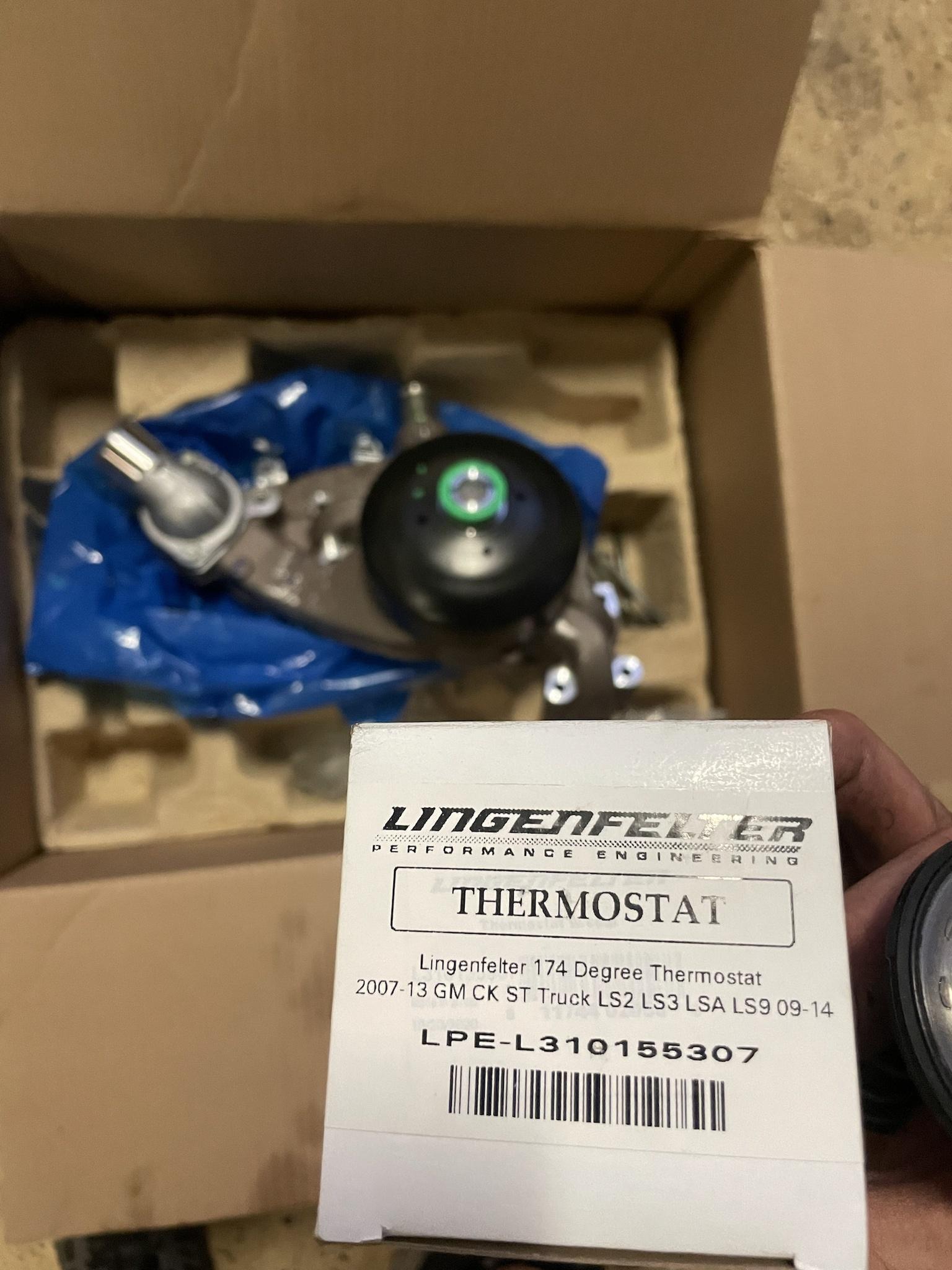

On my new setup, I changed out the thermostat to a
Lingenfelter 176° thermostat. While it was out, some of my buddies indicated that I should have looked at it as well as the old one and new one included with the water pump in a boiling pot of water, but I missed out at that point to double check. Some have stated that Ligenfelter or similar close ones are almost identical in temp to a stock one if you test it, unfortunately. The new 176° thermostat did help some with the new LS3 setup. Sits at 188° mostly. Isn't as low as listed 176°, but better than before by 10-ish degrees by circumstance.
Hope this helps. I was looking for a slightly cooler one to swap out with too, but went with this. Seems to be working.
Also... if you are replacing your waterpump, it may come with a new thermostat with it.. Again, my new one did (even though I didn't use it lol).
