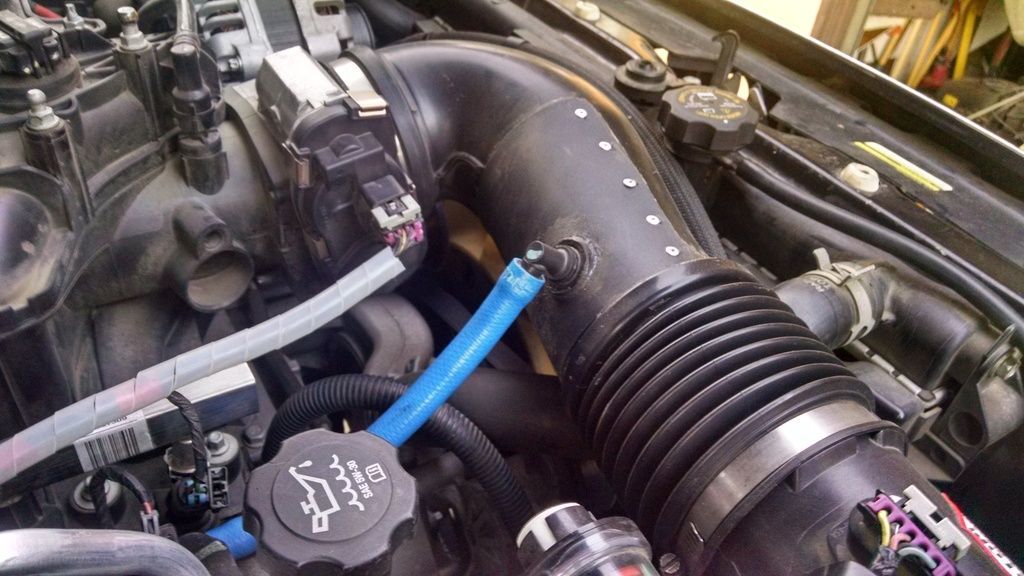

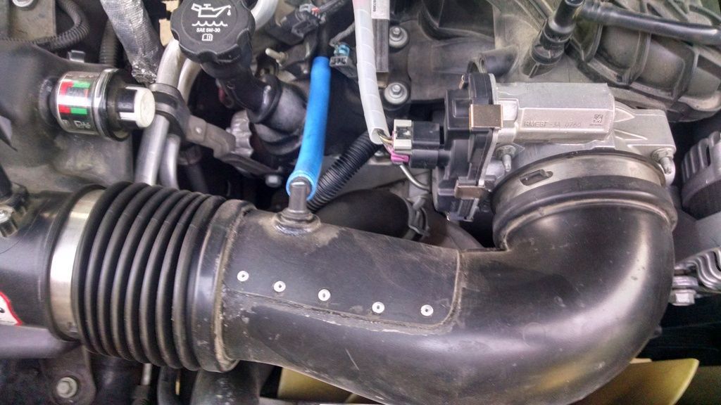

Gee, Doc, hope that's tongue-in-cheek...otherwise it's pretty harsh. No shame in wanting to save some money. The Airdoc, while very nice, just doesn't justify the price, IMO. Don't get me wrong, it's very nice. But as a family man with lots of other toys to maintain, it's just too much money for me to spend on what is essentially a tube and 2 couplers. Here's mine, cost= $0, and no, it's not a pringles can.
I actually was kind of forced to do this, as I was chasing down a wiring harness problem that would rear it's head while driving off-road. I needed to wiggle the wiring on top of the engine, while it was running, to zero in on the problem. Unfortunately, the resonator blocked access to that entire section of the harness, and since the truck wouldn't run with the intake tube/resonator removed, I had to come up with an alternative. Already had the 1/8" plastic, the pop rivets, the silicone... Zero cost, and it fits perfectly (of course), and accomplishes pretty much what your Airdoc does.
Of course, the I5 is different than the V8, but the same principals apply; get rid of the bulky restrictive resonator and provide a smoother path for the intake air, from air filter to throttle body.

Nice removal of the intake resonator.
But you are not really solving the issue of the restriction @ the 90 degree bend where the underside is bowed up into less than 2.5".

True. But that existing 90 degree bend, while shorter (top to bottom), still maintains closer to the 4" in width, as opposed to the 3.5" diameter of the Airdoc. That means that there is not alot of difference in the actual cross sectional volume at that point, and that "bow" is smooth. I actually think that the "bellows" section of the stock intake right at the airbox is more of a "flow" hindrance than the smooth bowed up portion at the elbow; The Airdoc certainly eliminates that bellow, although I'm not sure that's the best idea, as the bellow allows more movement between the engine in it's rubber motor mounts vs the fixed airbox than a short silicone coupler allows.
Again, for me, it was simply a means to access/manipulate the wiring on top of the engine WHILE it was running, nothing more.
