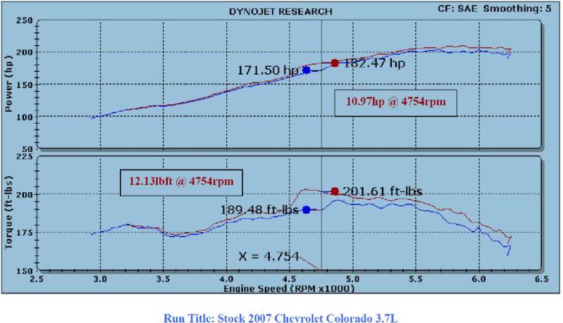

Here are some "actual I5 dyno numbers".
2007 bone stock in every respect 2007 3.7L Colorado with just and intake.
That's 2+ HP up every cylinder, which is better than many V8 trucks that may pick up 12-14HP (less than 2 HP per cylinder). When you actually test them, you actually know what happens, no need for speculation.

Doc- Looks like any HP or TQ gains on your graph all the way up to 4500 rpms aren't very relevant. The appreciable gains fall between about 4500-5000 rpms which unfortunately are so high in the powerband that they are rarely encountered in most normal driving situations. Even when I engage passing gear in my H3, the RPM's rarely exceed 4000-4500 RPM even at WOT, unless I stand on it for longer than needed.
That being said, the gains you've shown at high RPMS are more than I anticipated, especially in torque. Thanks for posting
