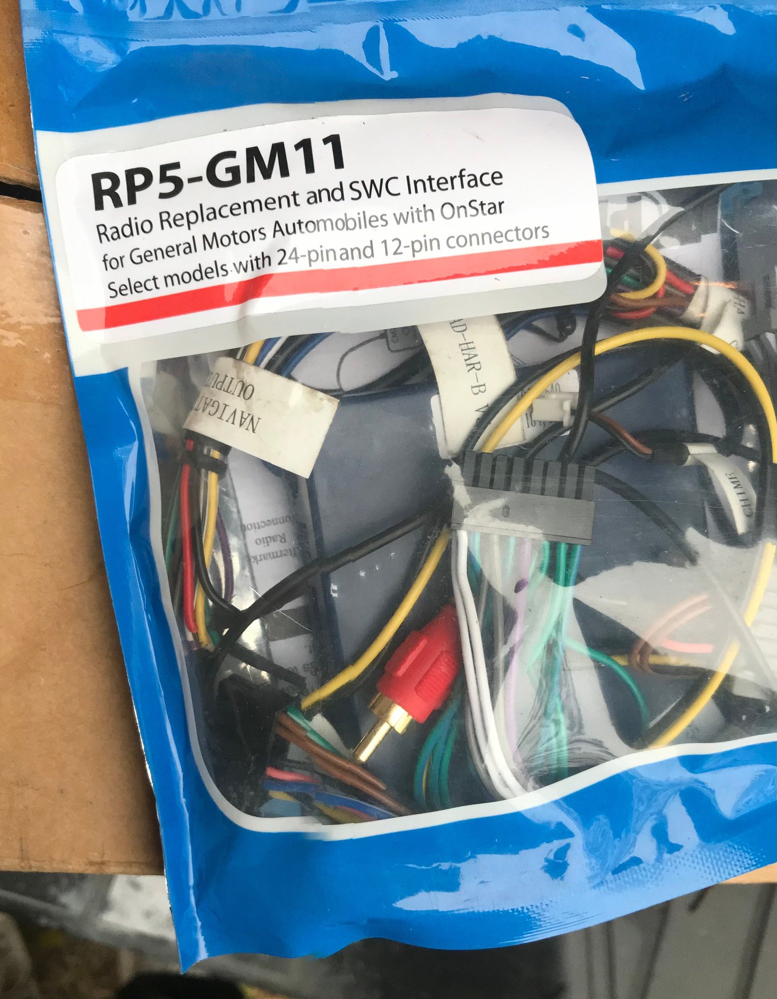

my H3 currently has factory radio, but had another aftermarket radio, so it still has camera
wired. They sold me the harness at Best Buy, I need to have dvds playing, what else would I need? Is there a manual or video to watch?

We need to know which radio you have in your H3, Monsoon or No. With an adapter, just follow the instructions.
With Monsoon I would use Crux SOCGM-17C -

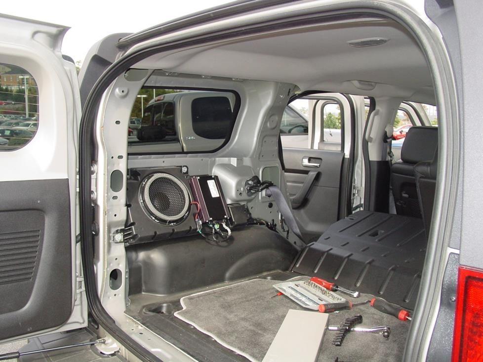

Monsoon-equipped H3's have an 8" subwoofer in the cargo area, behind a panel on the driver's side:

Yes it has a subwoofer - confirmed
