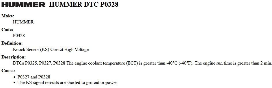

Hey all - 2009 alpha with 130k miles has been throwing an intermittent P0328 the past two weeks. I’ve been towing a camping trailer across the country during this time but the code gets set with and without the trailer. I clear the code when it trips and it usually stays away for a few days before coming back. I’ve also occasionally seen reduced power on hills, and today saw ignition retarded to -10 deg when experiencing the power reduction followed by the check engine light and P0328.
Codes are coming from my Scan Gauge II. I’m away from home and don’t have my scanner with me.
So, is this just a bad knock sensor or is there something else I should be looking for? Appreciate the help!

What are your Trans Temps? Coolant still look good? When the Aplha's get over about 227-230F for a few minutes, that will trigger the PCM into falling back to reduce power and heat soak, but that should be temporary.
Easy stuff first.... bad knock sensor or wiring to it.
Thanks doc. Transmission was good - below 190 when this last happened. Coolant has been running 200-220 and TFT 180-220 as I move across the country. Some of the long 6% grades pulling the trailer has seen coolant and TFT climb as high as 235 until I crest the hill, but comes down right away when we get to the top. It’s also stable in the hill climb if I stay in 2nd gear and 50 mph during the climb. Combined weight of truck and trailer is 10,000 lbs.
The latest power reductions have happened with just the rig, no trailer. Yesterday, the V8 drove like a beast in the morning, but then I parked it in the sun for 4 hours and it drove like a dog on the way home. This time it threw the P0328 at the same time as symptoms. Coolant temp was 225 when this happened. I wasn’t monitoring IAT at the time, but read that can also be a factor. Previously the code was getting set immediately at engine start (hot and cold) with no noticeable symptoms at the time the code set.
I’m going to try and get a new sensor today (it’s a holiday here in Canada) and see if that resolves it. Appreciate ideas for other things to look for.
