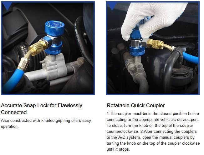

Get a manifold gauge set. Make sure to buy a set with adjustable couplers(non adjustable couplers have been know to damage the shraders and cause refrigerant loss), you only want to screw the couplers to the schrader until the pressures read on the gauges. Like this set:

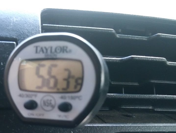

Electrical(blend door)? Same temp as outside? Do you own a thermometer?, Stick it in the center vent, ac on, low speed, change air flow selector, etc.. @idle you should see at least 40degrees below ambient temp @90degrees.

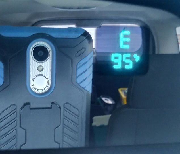

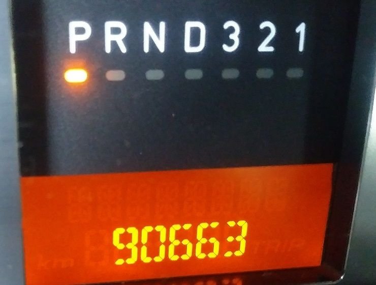

I just went out to my H3 parked in the back yard enclosed with fence around. It's 95 degrees outside, when I first checked temp inside it was 110 degrees. My ac system is all original and here is what I just got:
