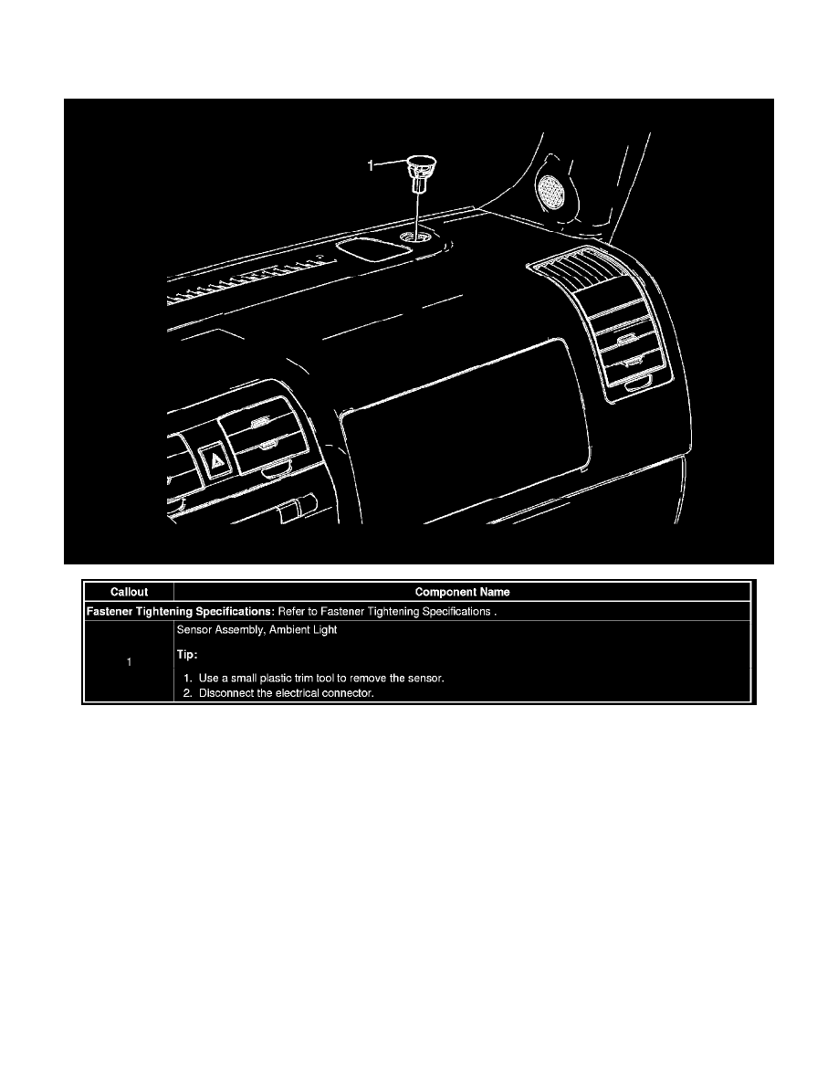

those illuminate with the cluster which is controlled by the sensor that controls the DRL's and headlights.

Well, I looked at the dashboard, in the center and there is no dome. There’s a square insert where one should be, but no dome. Could it have been placed somewhere else?

READ the Owner's Manual.
The light sensor is plain as day light (pun intended) on top of the dash over to the passenger side.

Thank you, but that doesn’t explain the AC **** lights going out, along with the headlight switch and window switch light. They go out and come on too.
OK, I give up. The illumination (lights) on the dash/switches/***** are ALL controlled in the same way that the auto headlights are controlled. If your H3 senses that it is dark outside, those will turn on. If it senses that it is light outside, those will turn off.

I understand what your saying, but when it’s dark out I don’t always have lights on the AC *****, window switch, locks and headlight switch. Sometimes they will come on and sometimes they don’t. I was just explaining some of the issues I have made note of.
I think I might need a new DRL sensor or relay ( I have both). I also have a headlight switch/**** panel I will be replacing in the next day or two.

Thank you for your help. I ended up replacing the DRL sensor on the passenger side dash. Apparently it was the issue and not operating properly. It fixed the issue and the lights ( all of them) are working now. Thanks again.
