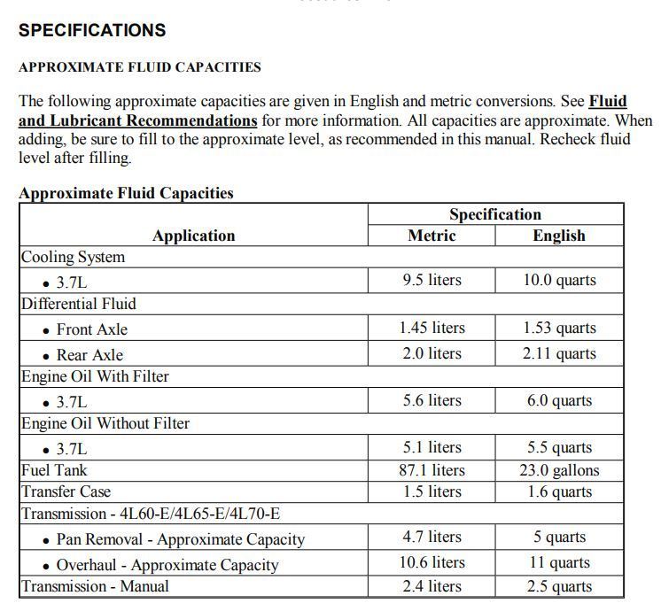

So I got the front end jacked up. No looseness detected in the hub ( no slop up and down or left to right) same with all the u joints. I did note a drip of front diff fluid on the drivers side of the diff.
I'll be draining and refilling that just to be sure there is the correct amount of fluid.
I can find the spec for 75w 90 fully synthetic however I cannot find the capacity in the owners manual.
Anyone know the capacity of the front diff of the top of their head?
Old Jan 21, 2020 | 10:34 AM
If you are changing diff fluid, buy 4 quarts & do both diffs.
