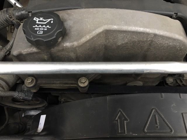

front of 3.7 hope my photo shows up

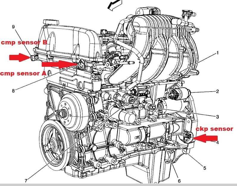

anyone know location of camsensors A&B on a 2010 H3 3.7 ?
Old Dec 19, 2020 | 02:08 PM
Posts: 9,017
Did you pull check cmp actuator solenoid? PIP3694F Did you check/clean connectors/contacts?
Did you need some pics? :
Old Dec 19, 2020 | 02:33 PM
frankp's Avatar
Joined: Apr 2018
Posts: 23
the diagrams are great , at least i now know that 'B' is easy to get at.
BUT on my 3.7 there is no camsensor in the location as per the diagram for 'A'.
Old Dec 19, 2020 | 02:35 PM
Posts: 9,017
I posted the part #s above, 08-10 only has 1.
