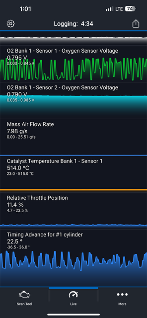

I was able to capture some live data this morning. I have a blue BlueDriver, so my screens shots are limited. I can collect other data upon request, but this is what I had trending this morning.
All charts appeared to be stable until the H3 warmed up. I am sure there are other components fluctuating, but the largest deviations appeared to be with the O2 Bank 1- Sensor 1. Take a look and please let me know if you have any suggestions. Again, I can gather other information. Thanks.

O2 1-1 and 1-2 seem to be reading the same value. usually the means the cat is not reducing emmissions maybe needs the monitor set with some drive cycles ? idk.
your absolute throttle posision also seems a bit high as if the pedel is being depressed by 22 percent. maybe dirty or obstructed throttle body ?
the MAF also seemes high but maybe because throttle position?

I am sorry. The data I posted is with the accelerator press slightly to keep the H3 running since it was warm and wanting to stall.
Below, I have posted new data with the car warm without touching the accelerator. Sometimes it will stay on after it is warm, but tends to oscillate on the rpm and run rough. When it does stay on and run rough, I can press the accelerator and release it to return the engine back to idle....it almost immediately shuts off. I can crank again with a slight press of the accelerator, but it will shut down or not crank at all when accelerator is released.
As far as the throttle body, it was removed from the engine and cleaned with actual throttle body cleaner.
Let me know if I can provide any additional info. Thanks for the help on this.
No accelerator pressed
