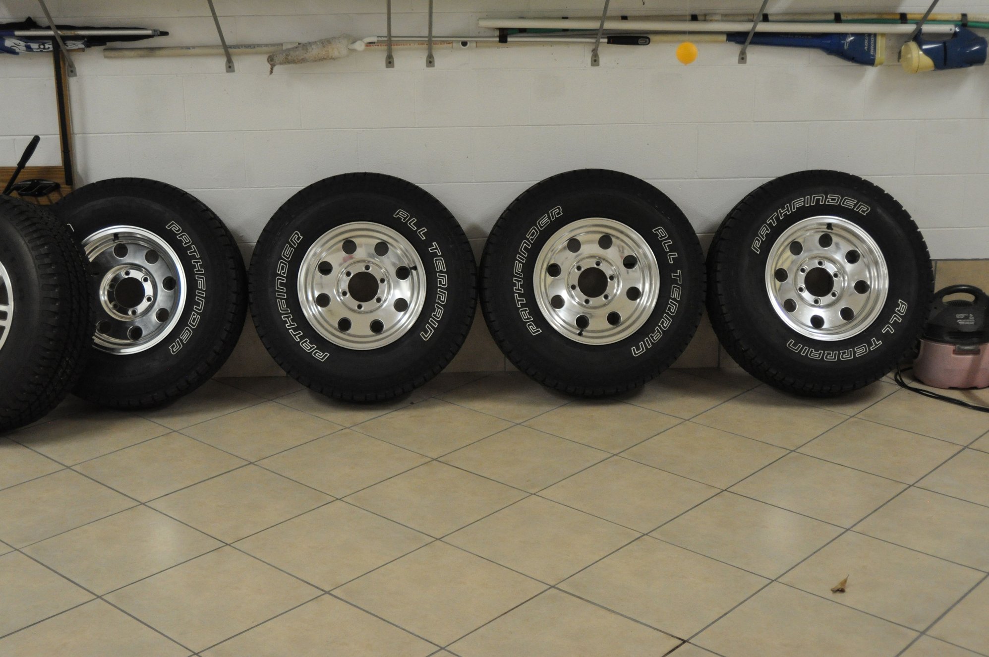

BTW, can't wait to put my new wheels on it after my buddy replaces all the rotors, calipers, with the brake job Tuesday. Also getting the AC charged back up, and I hope that works here in Florida, and a new range sensor on my auto transmission. Laters!!
BAJA 16" 265's

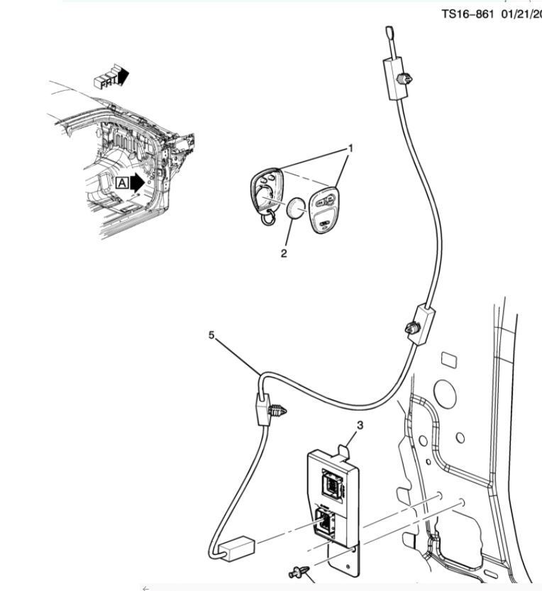

Anyone ever try replacing the GOD DANG RKE antenna, or cleaning the connection on the BCM and antenna or try to reroute the antenna higher or away from the radio antenna?
Never had a RKE issue in any of ours but I keep hearing people say they do and I have never once read about anyone asking about the "GD" RKE antenna!
Especially if the BCM got wet @ anytime it could corrode the **** out of the connection!
P/N 24300221
PART # 005
(24300221) Antenna,Remote Control Door Lock Receiver
ANTENNA, R/CON DR LK RCVR N153(06) 01 24300221
P/N 24300221
PART # 005
A true possibility. I know of one guy that fixed his that way, but then sold it a while later.
