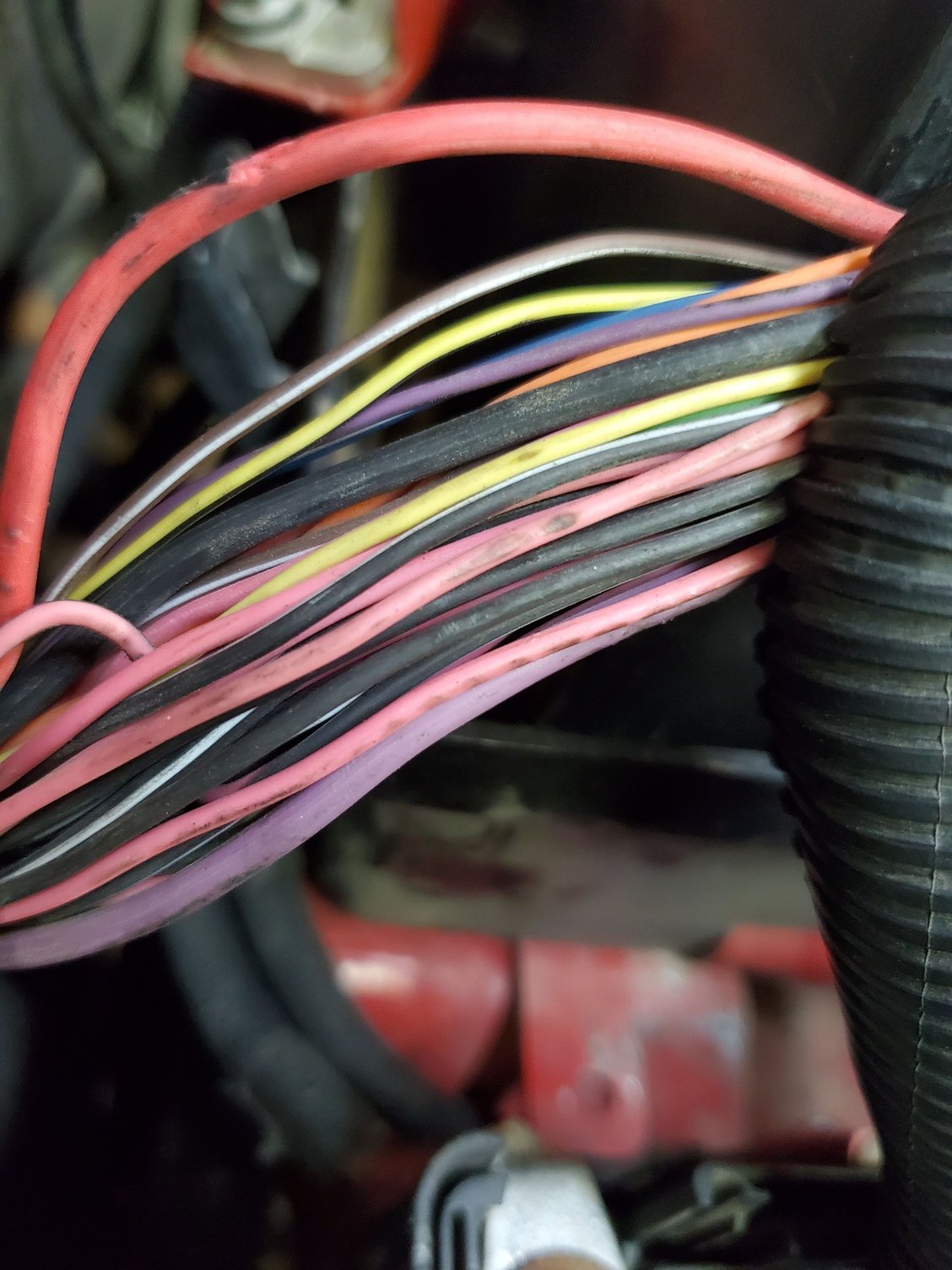

So I was leaving work when my h3 just turned off while in drive. I tried to restart but although all power was on I got no crank. Check the fuses and found #33 ignition 1 fuse blown. Replaced fuse and tried to crank. No crank and fuse had blown again. Never had this issue before so I pulled the TB to check the ignition coil wires which looked fine. I disconnected the plugs from the coil packs and retested. Fuse blew again. I ended up having it towed to my house and spent all of yesterday searching this forum and tried finding some help with no avail. I searched the internet with no help. Based on the wiring diagrams, I see that fuse #33 is for the pnp switch, clutch start switch and the ignition coils. Since it is an automatic I assume the start clutch would not be involved since I dont have a manual drive. I have not yet checked the pnp switch but the coil wiring looks fine. Has anyone else experienced this before and could anyone direct me on what I might check before I have it towed to a mechanic? I really like my h3, but if it turns off on it's own while driving, makes me concerned for safety reasons. Thanks guys for any help on this issue. I am going to continue looking into the pnp wiring in the interm and will report back if I have any luck finding the culprit for other members.

Wiring to coils is a common issue.
This will help you find the shorted wire:

Figured it out. After taking all of the wires out and looking everywhere it ended up being the main wires running from fuse block. Here are some pics.
