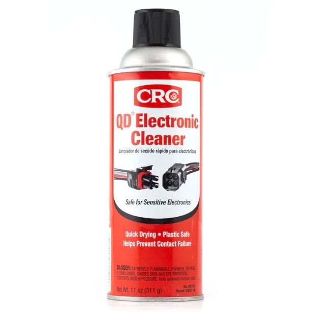

Another easy thing to look at is the T Case Actuator Motor. When they get wet, the motor itself and/or the wiring harness & Connectors (corrosion) to it can cause that issue. Get under and look. Inspect the wiring harness for chaffing, compromise, cracks, rot etc... Use CRC Electronic cleaner to clean the both sides of the connector at the Actuator, let dry and snap back together.
This chit is a MUST HAVE when you have an older vehicle.
