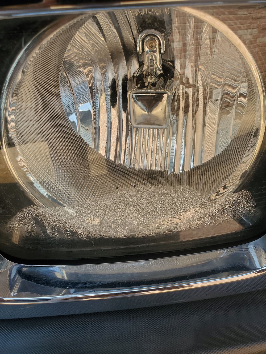

I wanted to see if you guys can help me get these small issues worked out. The first one is my headlight I'm not sure how to clear the water marks.

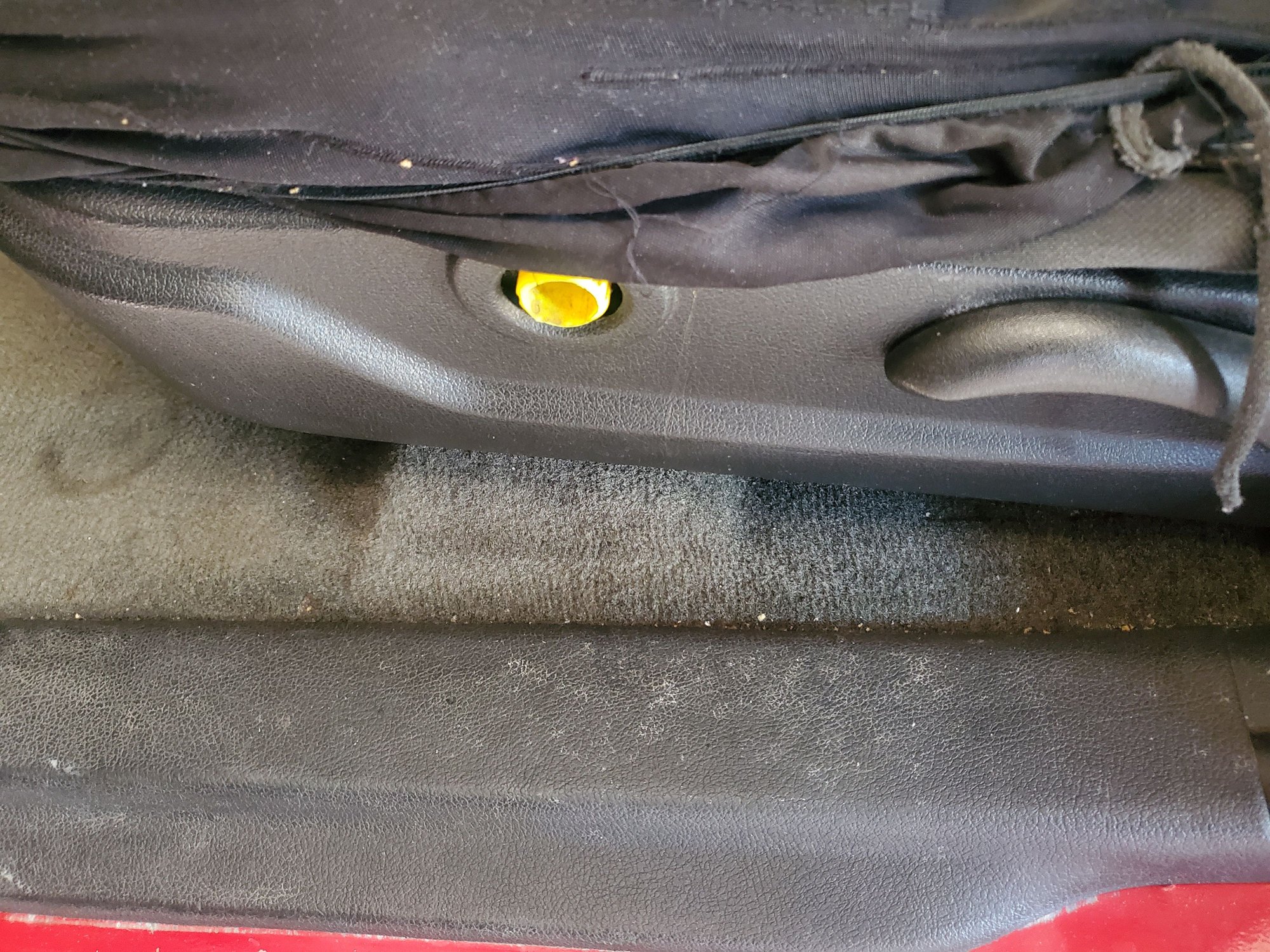

Not sure what goes on the yellow handle or where to buy it.

On your 1st image if your talking about the condensation. Try runing a hair dryer on it to evaporate the water.

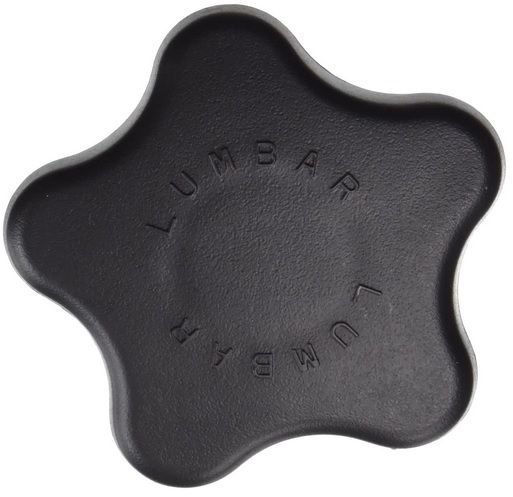

3rd image you are missing the **** that adusts the lumbar setting. Try searching for the part number.

Originally Posted by Alex DjFlaco
Hello everything,
89042211 89042211
