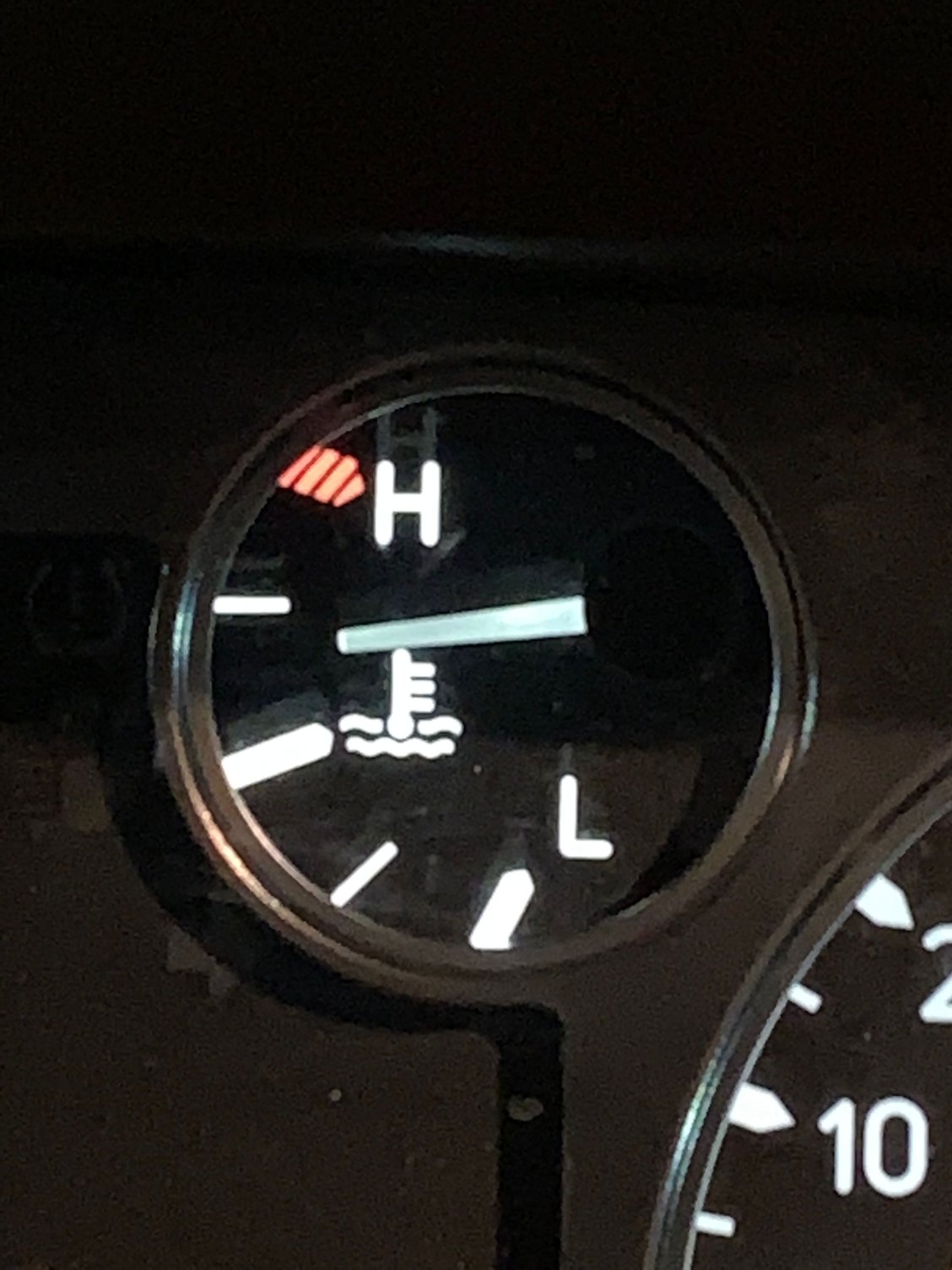

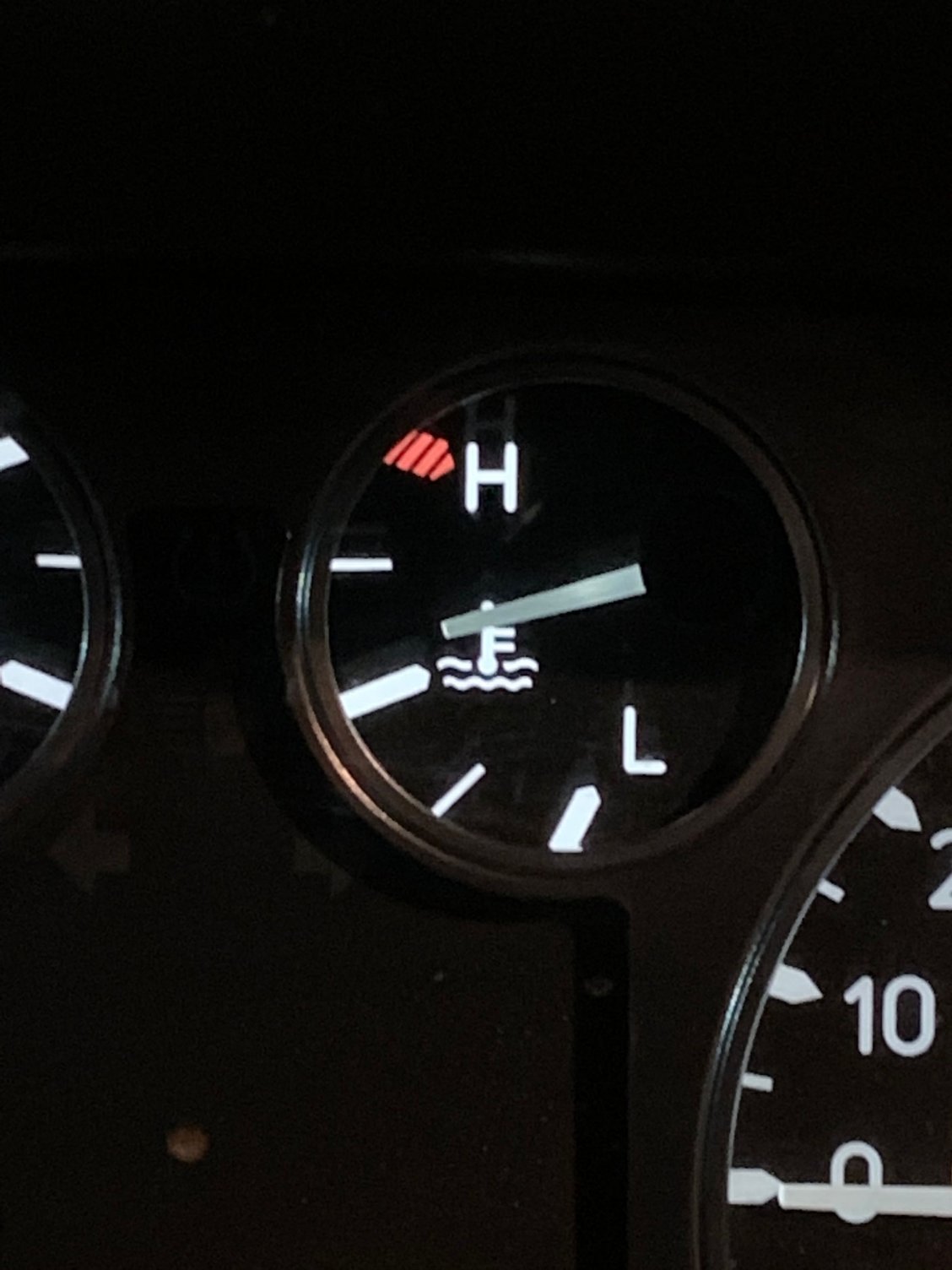

Well, I plugged in a reader and looked at live data. I had to take pictures to keep it all straight.

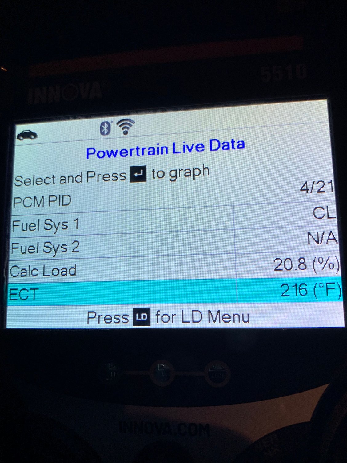

After about 15 minutes of driving and a few idling in 46 degree weather my gauge stayed at this point.
The reader said 216 degrees.

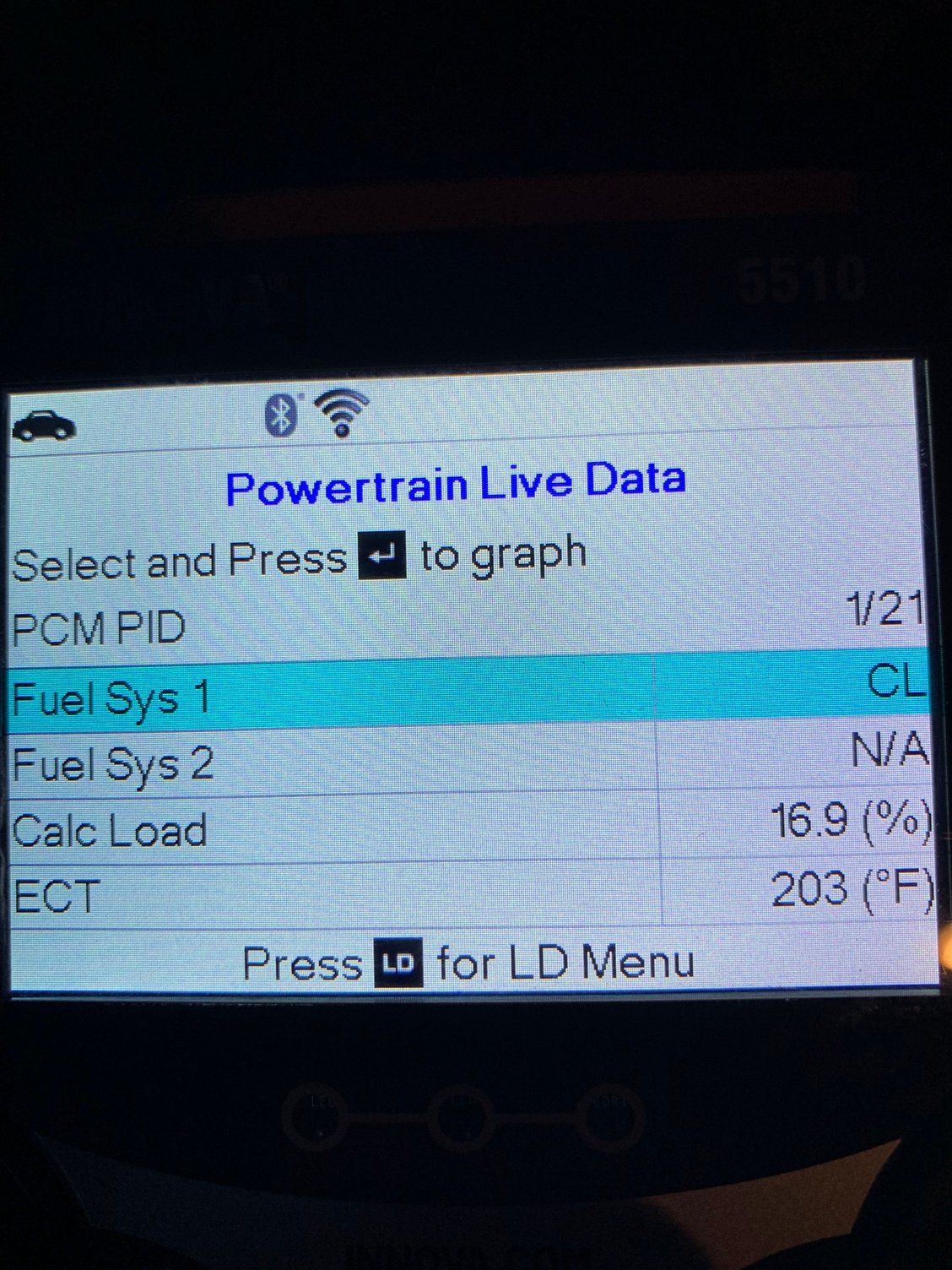

I gave a little gas to bring idle up to 1500 and waited a minute or two. The gauge lowered to this point which is about where is is during normal driving now.
The reader said 203 degrees.
So pre-radiator temperatures are anywhere from 203-216 degrees after a gentle drive in the winter. Im guessing I will be above that 220 degrees with any kind of demanding driving.
