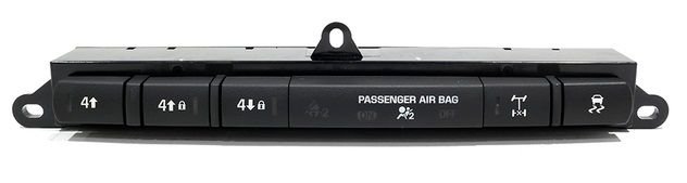

Your switches & light indicators work? Any codes?

You do not need anything to do with neutral to shift to HiLock. Have you backed up on loose surface turning back and forth? That is usually all you need to do to unload the torque built up holding it in HiLock.
Clean the T Case control buttons with CRC Electronics Cleaner. On a loose surface, shift into Hi Lock drive a short distance, then Lo Lock drive a short distance, then shift back to Hi Lock, and then back to Hi.
If none of that works, check the shift motor and its electrical connections.

Originally Posted by Jruark
Yes, all the lights work and buttons work. It shows to be working, but is locked up in hi
PIP4161
Subject: Service 4WD Light On and The System Inoperative, Switch Contamination Models: 2006-2008 Hummer H3
The following diagnosis might be helpful if the vehicle exhibits the symptom(s) described in this PI.
Condition/Concern:
Some customers may comment about a Service 4WD Light on and transfer case or rear differential lock system inoperative. Technicians may find various switch DTCs or open fuses and the transfer case select switch contaminated
Recommendation/Instructions:
A number of 4WD switches have been received through the Warranty Parts Center that show obvious signs of contamination caused by liquids being spilled through the HVAC vents. On an H3 vehicle these liquids will run in behind the IP face plate and leak into the 4WD switch, the radio and if severe enough may also cause various fuses to become open.
