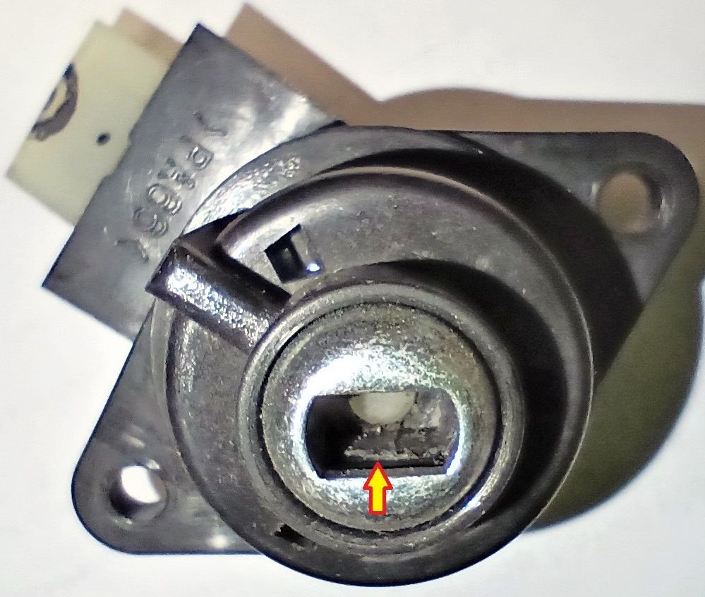

No chip. Clean the ignition switch. If hummerz was on his game today, he would have provided you with the attached informative pic he put together.

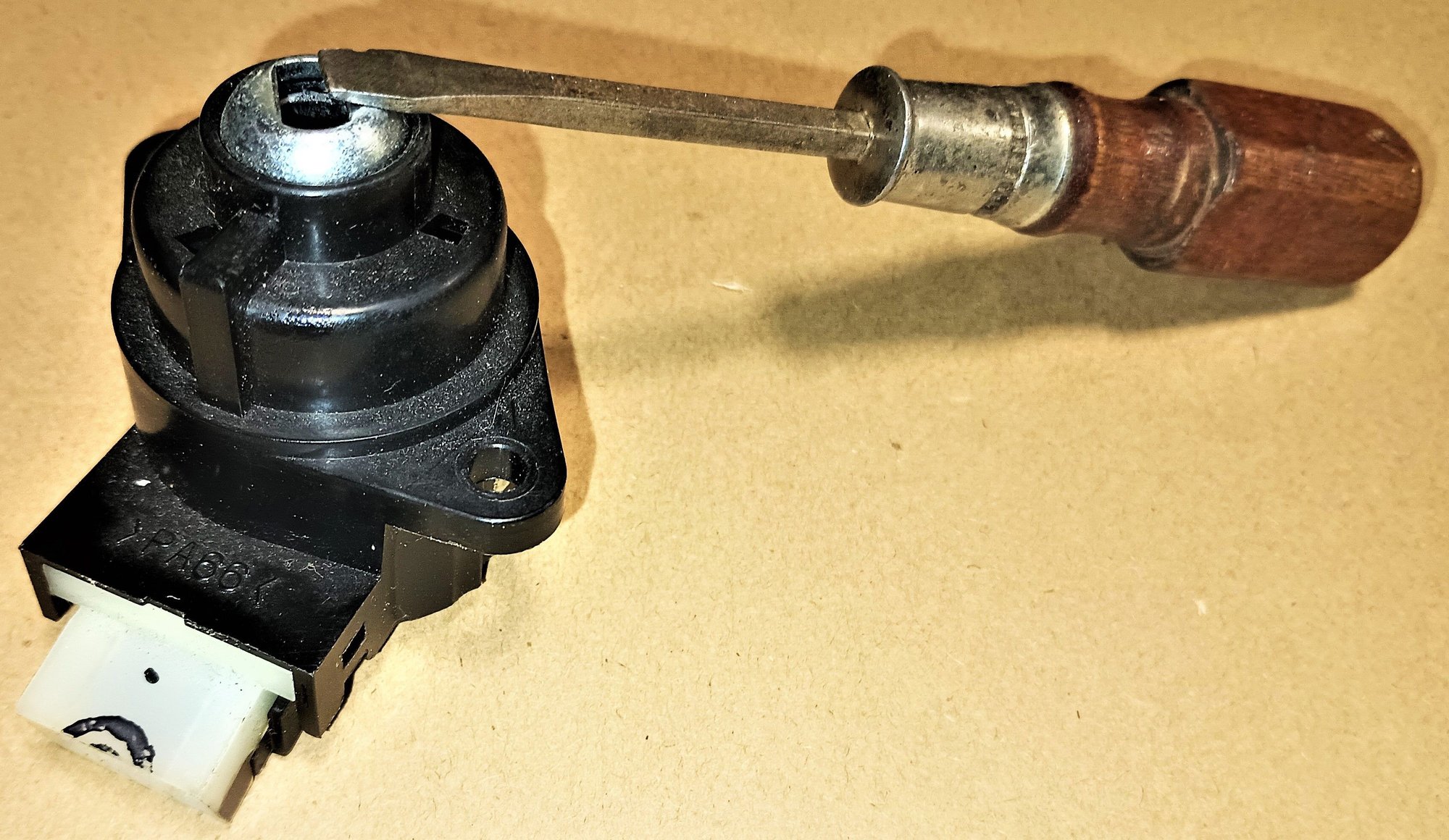

Hold my beer and watch this:
Old Feb 5, 2023 | 12:49 PM
Justinh's Avatar
Joined: Feb 2014
Posts: 477
From: north Alabama
What is he turning? Is that the end piece on the ignition switch?
Old Feb 5, 2023 | 02:16 PM
Not the metal retainer, under that is a plastic insert that rotates -off-on-run-start. It takes the right size small blade screwdriver that will rotate the plastic insert since the metal retainer does not rotate.
