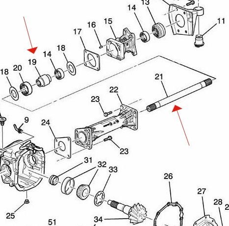

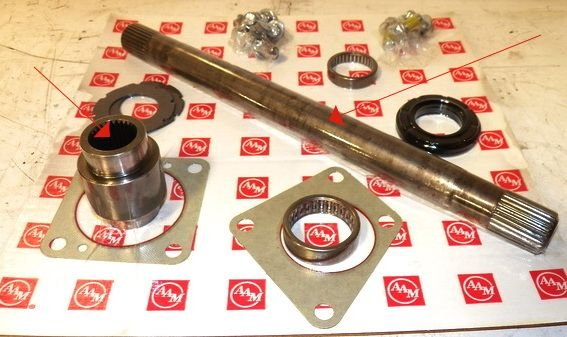

So, where I work we stock alot of AAM differential parts. Since I have a 2007 Hummer H3 - I decided a long time ago to purchase AAM kit# 74080005. Iv'e had the kit for may years now -- just sitting on the shelf incase I needed it. I have had several calls looking for this kit or just the intermediate axle shaft (GM 12479254 or AAM 40045261).
Question is: Has anyone found a source for these?.. What have yall' been doing if this part goes bad?
I decided to finally look into having the intermediate axle shaft (GM 12479254) and the output shaft shaft splined coupler (AAM 40017351) fabricated and offer a kit. I doubt this will be cheap by any means and I have probably have to commit to 10pcs or so to get a slight pricing discount.
I have talked to several of our normal suppliers / machinists as well as the normal 2 big axle/diff companies. I decided to finally crack open the new kit and send the 2 pieces out to the first company to get a price quote. I am still waiting to get the quote and then I might possibly send them to another company to be quoted as well..

We sell these AWD shafts for another GM platform and can have a run made pretty easy if there is a demand. The coupler is a whole different project but I wonder how many of those are being broken vs shafts

10 in stock ready to ship:
https://www.outfitterdesign.com/h3-f...ate-shaft.html
We havent run a stock front diff in years but it was interesting that the old diffs we pulled apart to get a sample of the intermediate shaft all had worn out splines on the coupler side. This will fix that problem!
