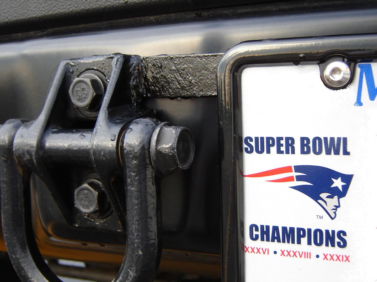

Um, remove the 5 bolts that hold it on, locate some tow hooks from an SUV that had an interior mounted spare tire, and either buy a plate reloacation kit or make your own. I made my own. Dont forget a plate light, just spline it into the original plate wiring. I rounted mine through the bolt hole that will remain open when the SUV tow hooks are intalled.
What she looks like now...
