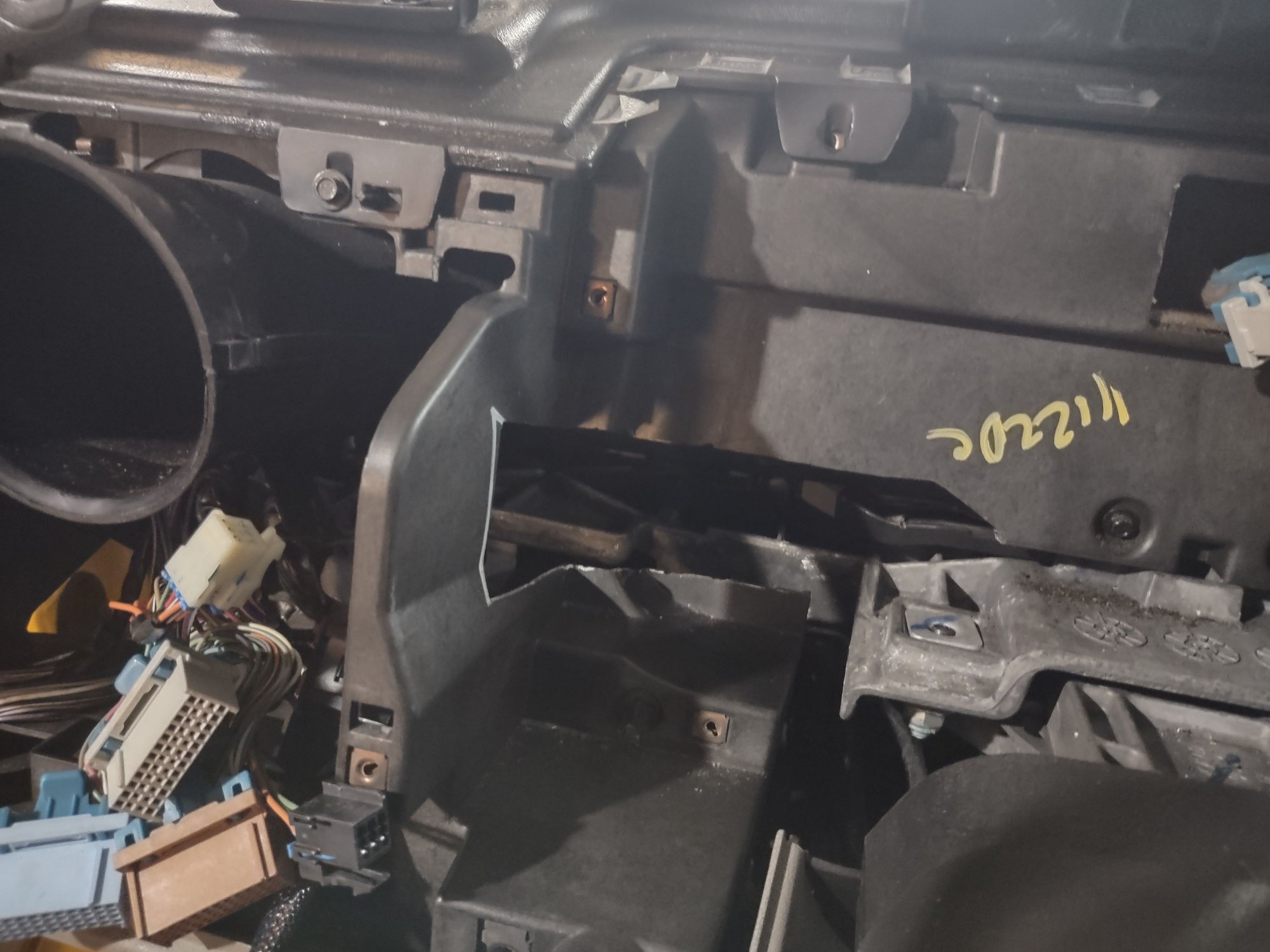

Digging into it today. Really appreciate the previous owner.... Obviously had the BCM repaired or replaced before, put a nice cut out behind the cluster to make it easy. Literally 15 minutes to get the BCM out. Priceless

And 5 minutes to tuck it back in and plug everything in. It made the BCM swap a 30 minute ordeal while drinking my coffee. If I was in a hurry I could probably do it in 20 minutes. What's the normal shop right on this? Something like 6 hours? OMG
