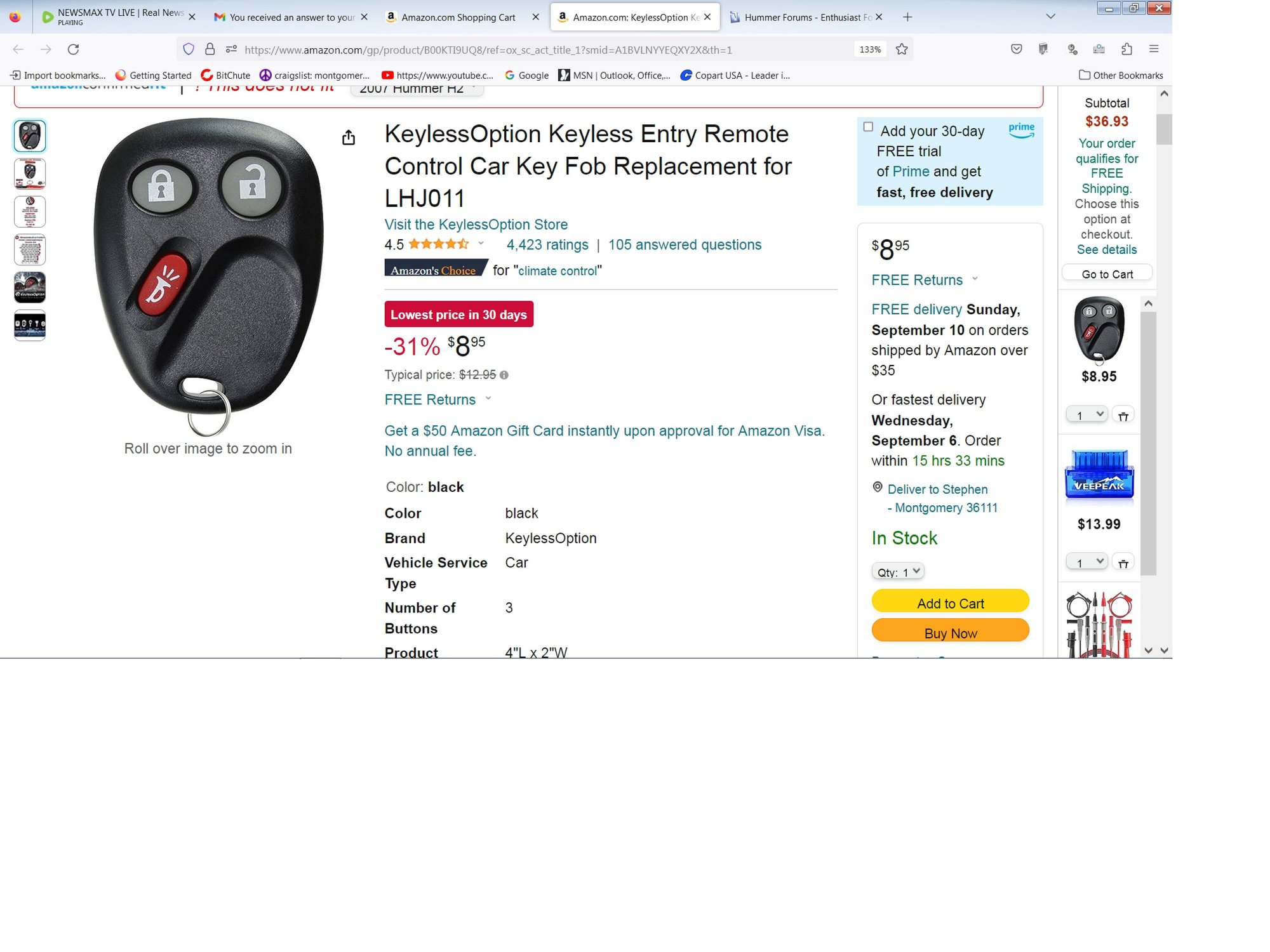

Hello I’ll be needing a key FOB for keyless entry.
This
https://www.amazon.com/gp/product/B00KTI9UQ8/ref=ox_sc_act_title_1?smid=A1BVLNYYEQXY2X&th=1 https://www.amazon.com/gp/product/B00KTI9UQ8/ref=ox_sc_act_title_1?smid=A1BVLNYYEQXY2X&th=1

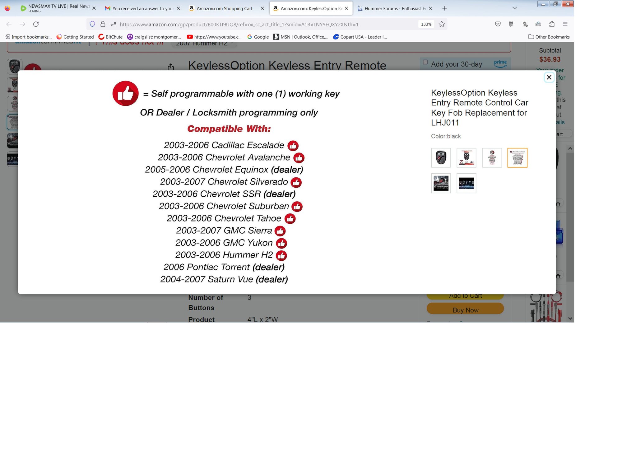

the ppl at e-bay claim this model FOB works w/ 07 H2.
A lot of the time amazon has misinformation here there claiming this only goe’s up to 06..
This
how do I know there's electronics inside this el cheapo FOB like isn't there a possiabillity it's just a empty case?
won't buy w/out free returns
I forsee problems ordering GM parts for the H2, had major problems w/ the 07 saab 97x
should I just ditch the name H2 an just tell them I have a silverodo 2500 truck
Thanks for advice

The most foolproof is to determine the correct FCC ID that you need and then make sure what you are buying has the same FCC ID since that # is for the specific licensed frequency. If you have an original remote then it should have an FCC # on the back of it. If it does not then (at minimum the casing) the remote is not an original one.

the H2 was delivered w/ just one key (it looks like a household key, like there isn't a anti-theft pellet builtin) no FOB. so I can't retrieve any #s off FOB. is the shape and style of FOB for a 07 like the shape I link to.
place I'm ordering from has free returns so I'm not out but a little time to send back if it doesn't work.I have more confidence in e-bays saying it works for a 07 than this other place. will report back w/ results.
thanks

Confirming the 2007 keyfob is the one in the photo. Same as our 07 fobs

Simply check FCC ID & part #
I've never had a problem with any replacement RKE's received from eBay! I've purchased many for around $5usd each on eBay, for different vehicles over the years. I added 2 to my 3.
Research & buy the correct RKE(at the best price available), receive it, program it. Done.
