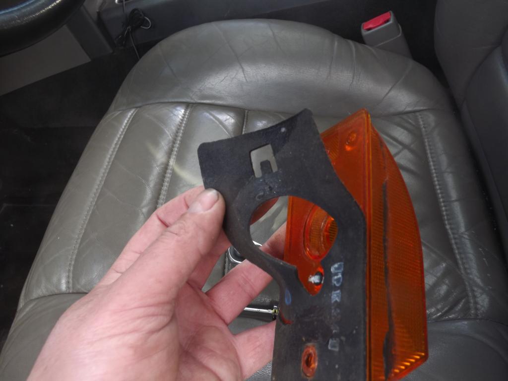

While your up there tear the gasket off the bottom of your roof light its a bloody sponge

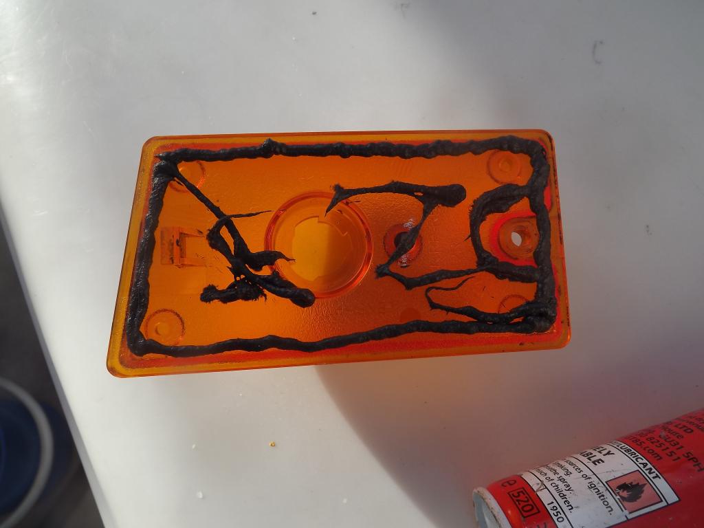

A bead of silicone means water will never get under your marker light though it doesn't really matter as the roof rails are designed to drain under the light any way .
