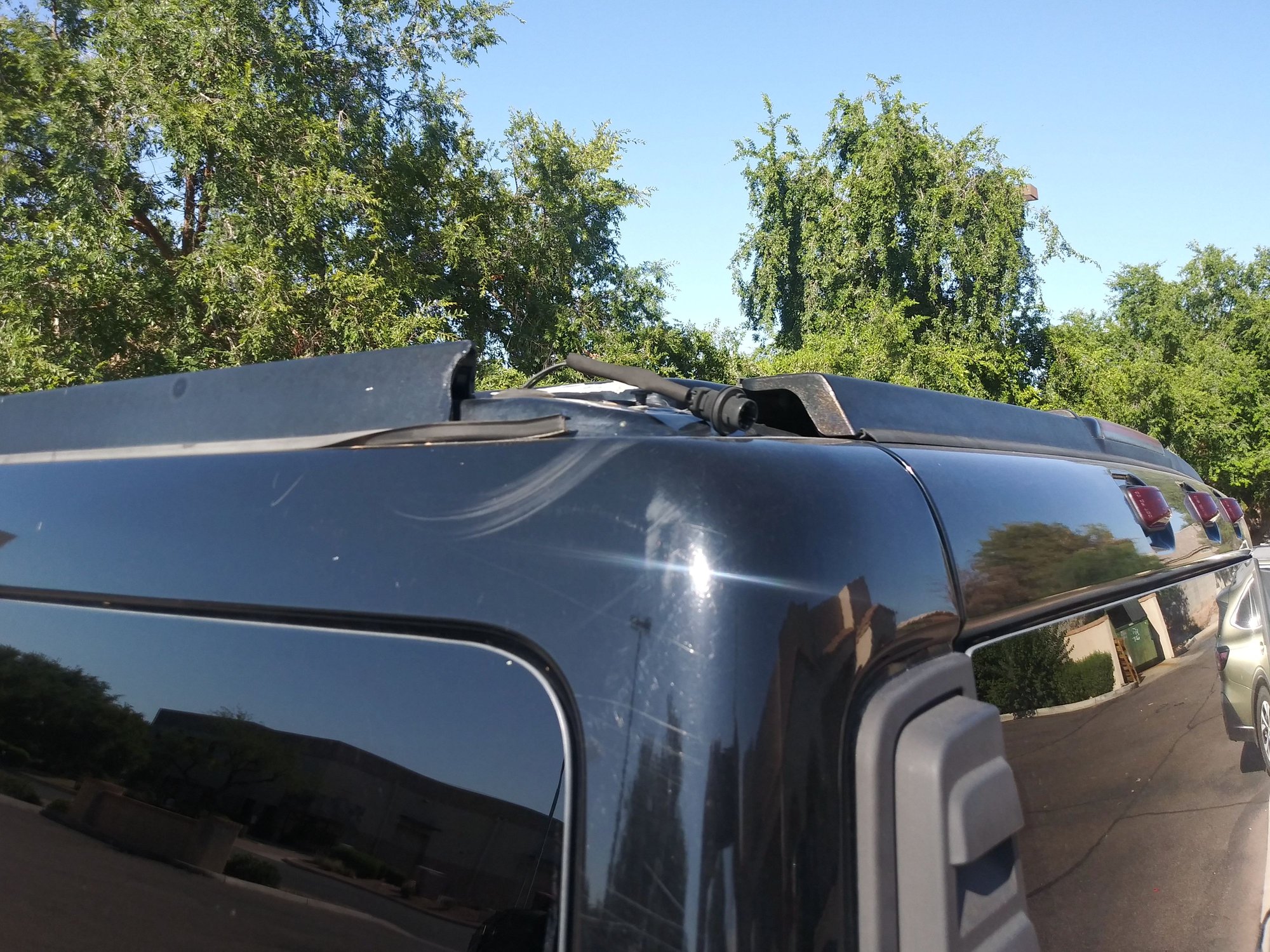

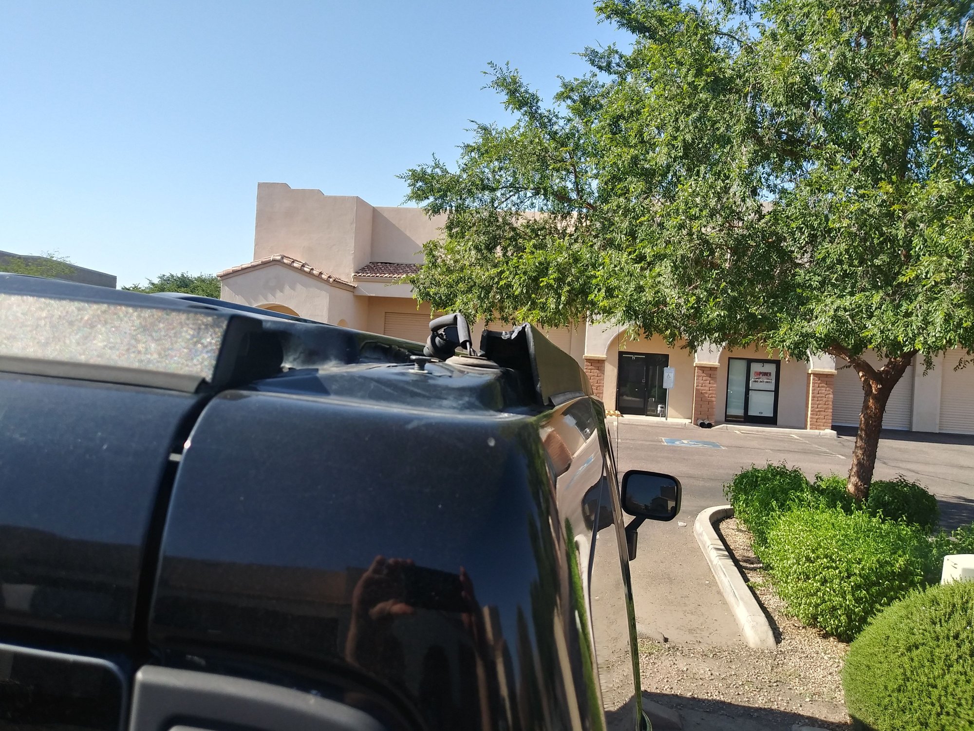

Greetings,
About to pick up a 2004 H2, went to look at it today. It needs a few things, one of them is these plastic pieces are broken on the very top of the truck. What are these called, and anyone know where I could find replacement ones?
Thanks

Dang - looks like they mangled both of the roof rack/luggage carrier rails and both of the end pieces are missing as well as the rear corner lights. Parts are not cheap for these.... Link below for part numbers.
https://nemigaparts.com/cat_spares/e...n/17/tn17-011/
Looks like you need all 4 of the first parts listed. Can find them on eBay usually. For the lights there are used OEM ones or aftermarket ones on eBay as well.

I had the wrong parts drawing up.... the first one was for the SUT. You need the ones for an SUV which are a lot longer.
https://nemigaparts.com/cat_spares/e...n/17/tn17-010/
This is the main page to look up all parts - https://nemigaparts.com/cat_spares/epc/hummer/
You may need to dig through more of the pats pages to be sure. There is a metal rail as well plus the plastic part.
Hopefully the interior is all there and good. Many of the parts for H2's have become very expensive due to their age. An excellent condition door panel can run well over $500 as an example...

Gotcha, thank you. I think the roof plastic is in two separate pieces that meets in the middle, hard to tell because the vehicle is not with me at the moment.
