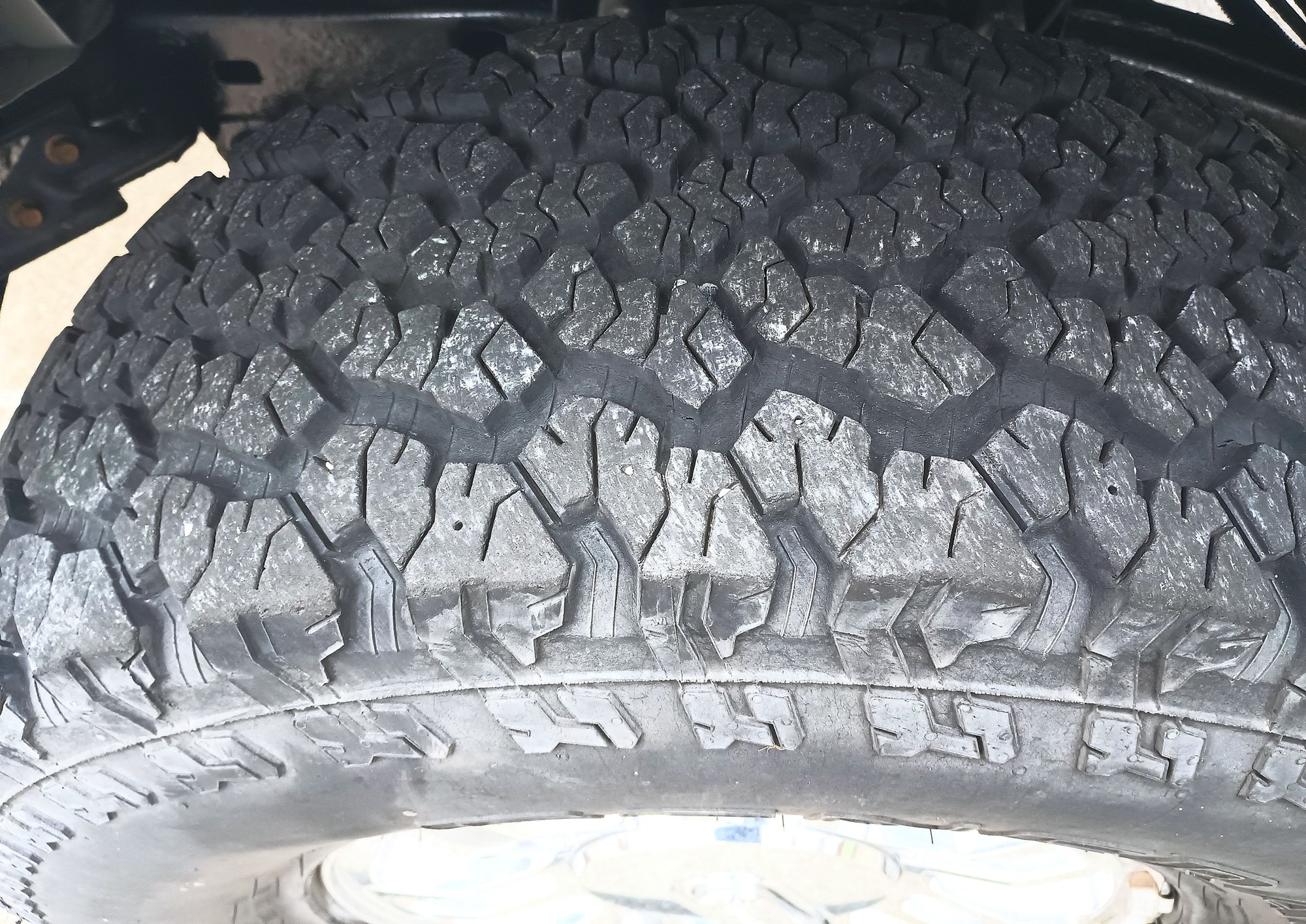

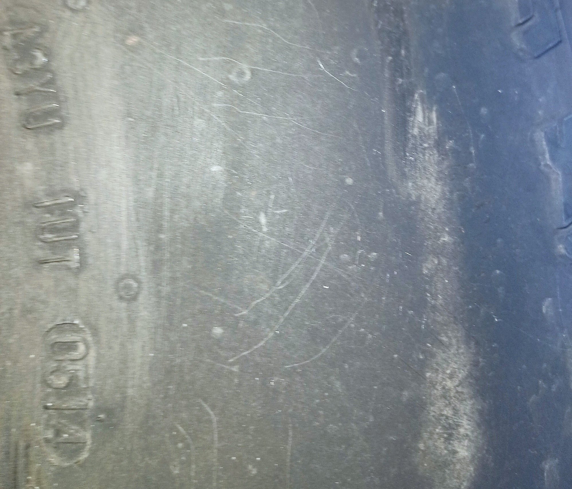

My Generals Grabber AT2 are over 12 years old (0514=5th week 2014) I installed myself back in 2014 never needs air & not cracking.
General Tire is currently owned by Continental AG Germany
My wife also loves the Continental Cross Contact ATR tires I put on her ride.
Today's pictures of the tires
