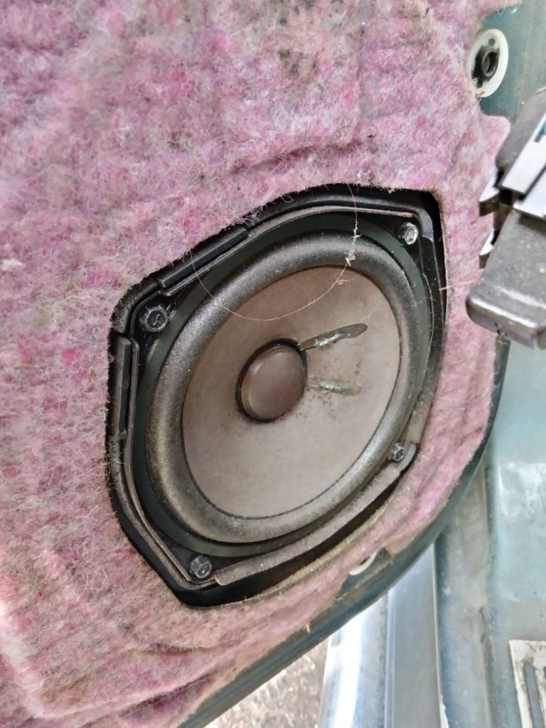

do these speakers appear orginal to the 07 H2? thanks
rear
front

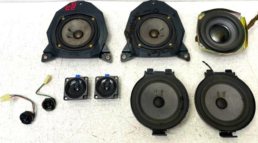

Originally Posted by HandsomeSteve
yes I can do that. I was hoping for infor on the orginal speakers an radio. the fronts are unekic can't even see screws.
ALL 9

thanks hummerz that's very kind of you to post images . it's cold outside kindof wanted to avoid removeing speakers.would you happen to have images of Bose head unit an amp.an there locations?
mine appear to be Bose. looks like the fronts are 6.5" an rears are 5.25" I see the tiny ones in apillar an the mids in rear hatch area but
1.where is the odd one upper right of image what I think is a sub. located? could those ribbon cables plug into a amp?
2. are the bose speakers amplified or just powered from the head unit? if amplified where is the amp located?

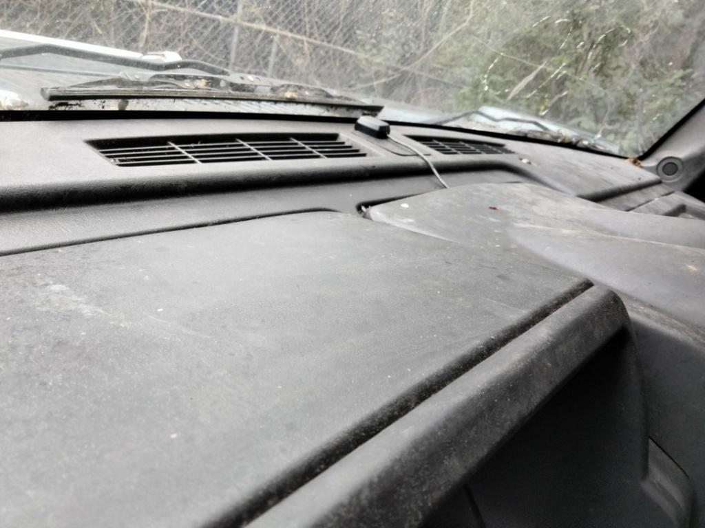

3.I see a small silver box under the driver side 2nd row seat, it appears to be audio/video related it's unplgged?
the cable has similar pinned terminator as my boats chart plotter/dept. finder so I assume it was the original GPS box plus it's dissconnected.
I make this assumption bc 1 it's dissconnected an 2 there appears to be a after market GPS antenna on the dash.

the crusty box says it is a fm audio transmitter so most likely aftermarket probably some entertainment system or dvd player or game console audio interface
the bose amp is bolted to the floor inside of the center console.
the bose subwoofer is on the firewall side, center clusterfuk / airbox / center console transmission hump area

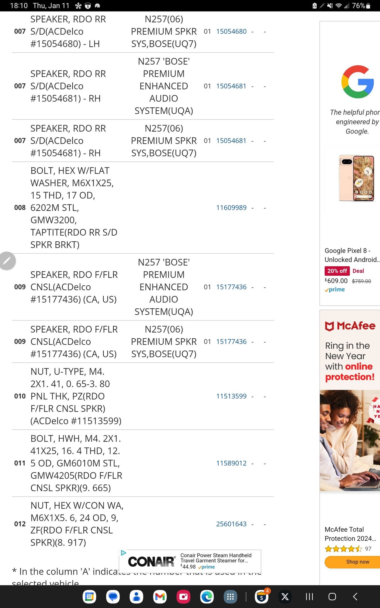

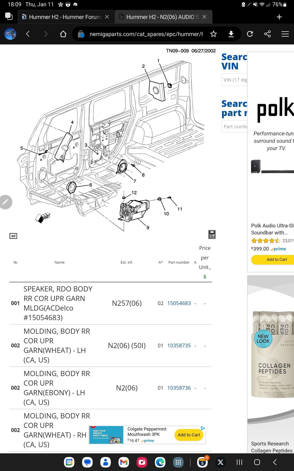

RE #1 - That odd speaker is part of the delux Bose system in the center section. See attached pics of Audio system speakers.
RE #2 - it is under the center console (under the console storage compartment).
RE #3 - some PO aftermarket item. Get rid of it.
RE #4 - BOSE systems are VERY good quality. My 03 system sounds great. When alone, throw a CD in there and crank it up - sounds like I'm in a concert hall. Plenty good for us "average" people. A lot of the audiophiles will disagree. If you like it, why spend money you can use to repair/upgrade some other item.
I have no input for 5 & 6.
Enjoy your ride.

thanks for exploded view so #9 is the sub. weird it's made by ac delco or they probley just put there name on it.
