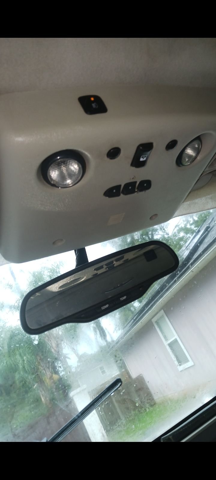

Switch on overhead console on my 03..any idea?

I've looked around and can't find another like it? Thank you

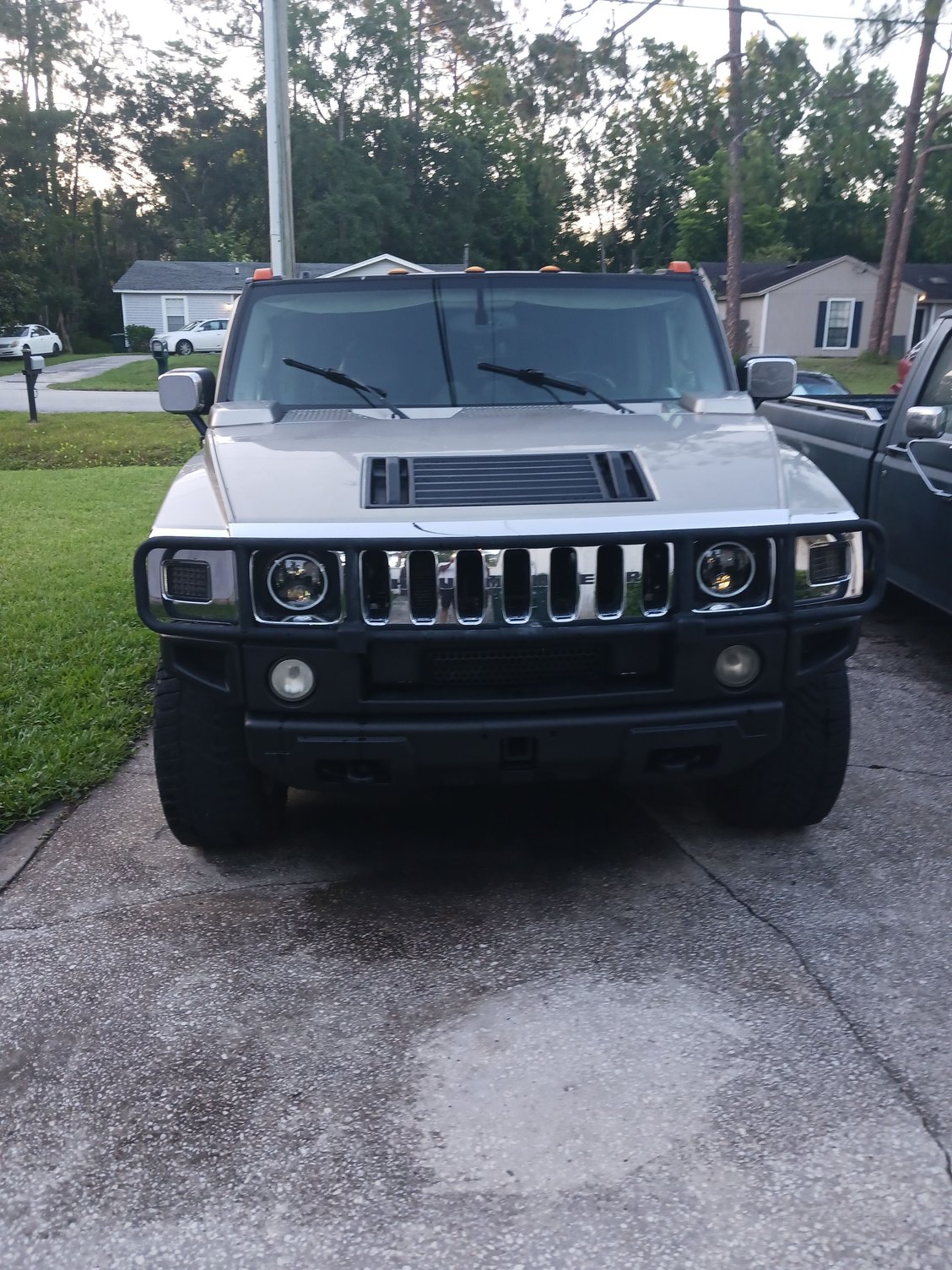

Yours either came with front brush guard aux lights or roof rack aux lights.... mostly likely on the front brush guard. Probably plugs for them behind the grille hanging there.

Thank you for the reply. Maybe they control the round fog lamps in the front bumper...I'll have to check.
Are the round fog lights built into the bumper the front brush guard aux lights?

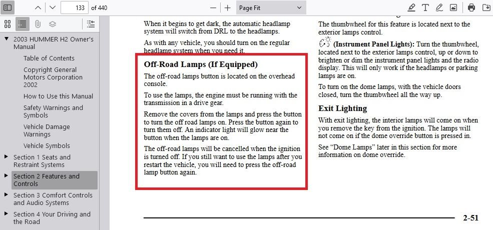

Did you read the manual I posted above? "REMOVE THE COVERS FROM THE LAMPS......"

If my H2 had these they are long gone lol. I'm going to look for plugs behind the grille as suggested . Thanks for all the replies. My Best
Those are DRL’s or daylight running lights.
They are activated by daylight only and turn off by the sensor when daylights dim and your regular lights come on when they are set on auto.
You can bypass them on the fuse panel by linking the together on a module.
Got to look up the picture of mine H2 fuse panel how I bypassed them as it been a while but mine don’t turn off when dark.
