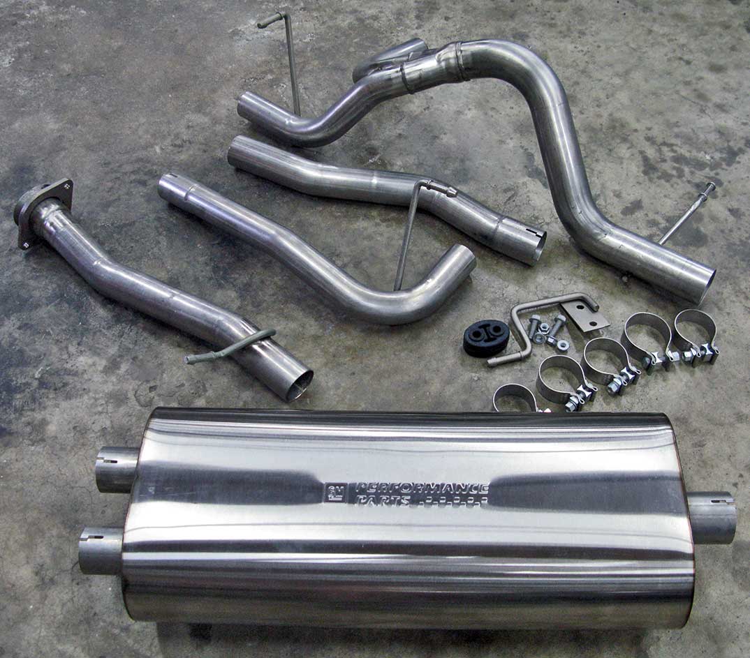

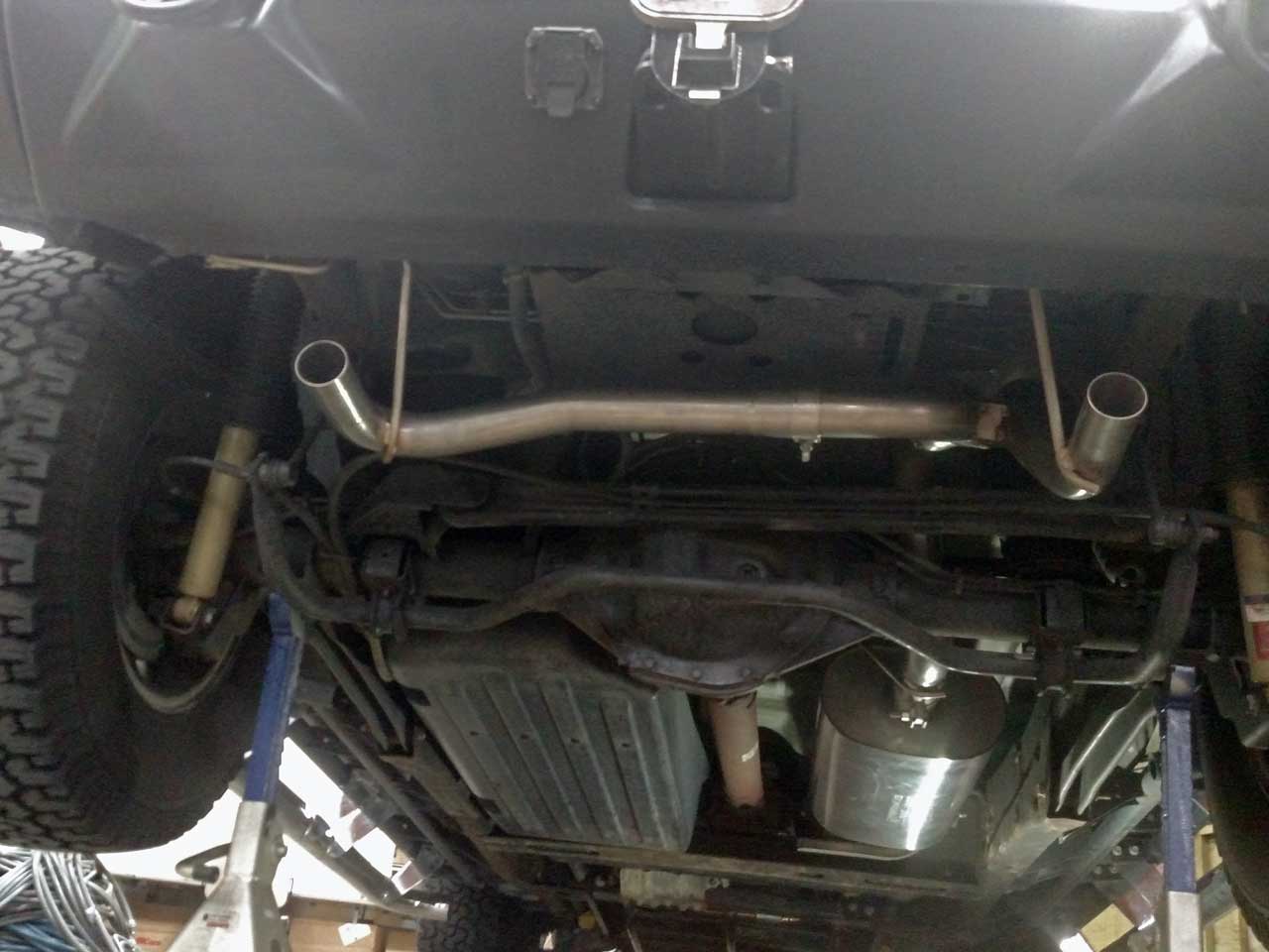

So in the end I'm happy. It does have a nice low rumble now and has the distinct metallic sound of the bare stainless headers too and no drone at all. From behind when you get on it, it sounds killer too. Last bit to add for the exhaust will be the Borla made GM dual wall slant cut tips which Borla happens to have in their closeout section on their website. Had to buy two - one thing I had no idea of with this GMPP exhaust is that it brings duals out the back. Like the stock exhaust (on 03-04 models) its true duals until after the muffler. The stock went into a Y after the muffle to a single downturned outlet. The GMPP one goes from dual to single in the muffler itself, then a y after it goes over the rear axle.

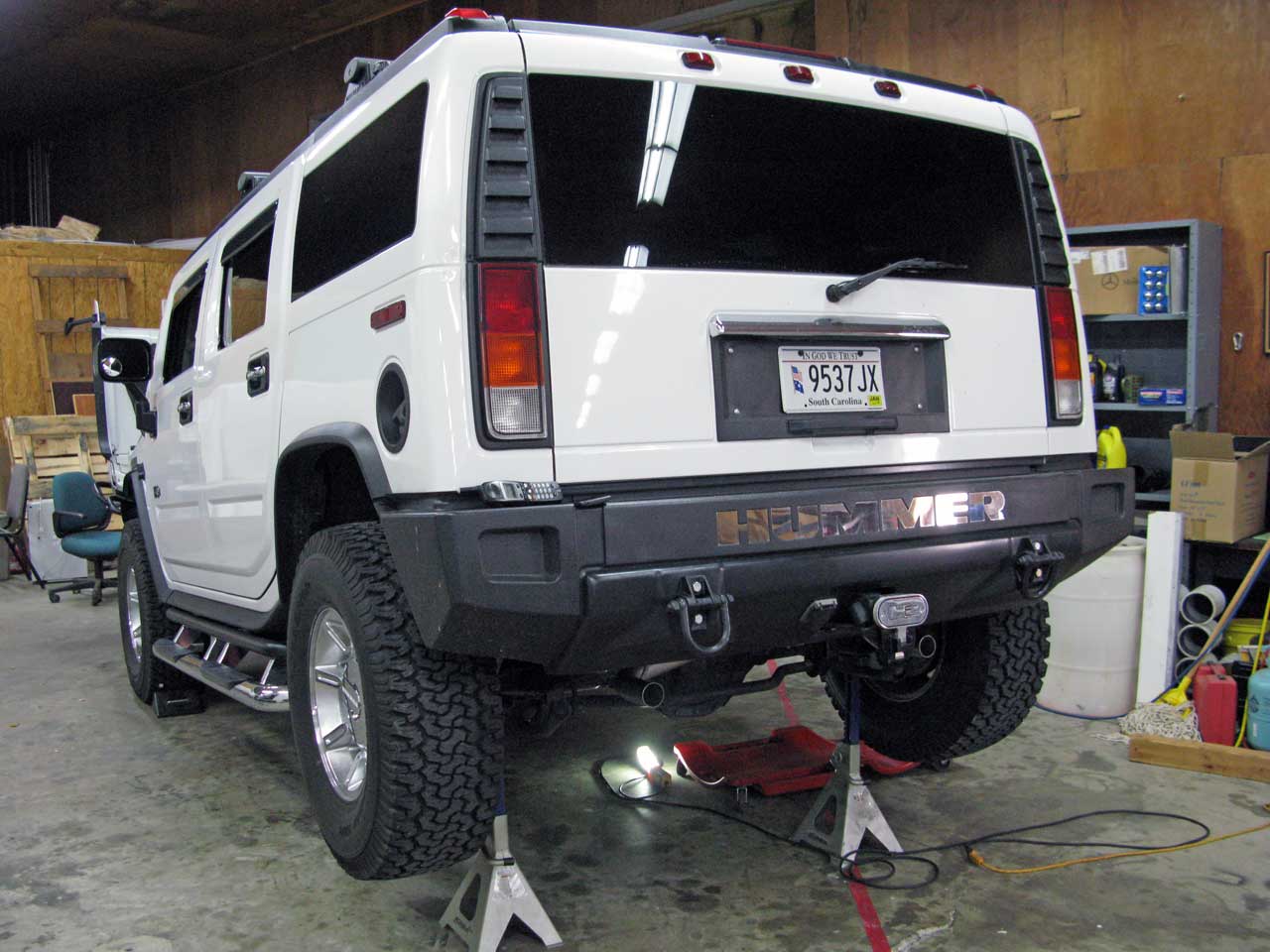

Couple of obligatory pics.... Will post again on this once the tips come in from Borla.

I think the tips will help the look a good bit too. The GMPP kit narrows down to rather puny looking 2.25" pipes. The factory tips flare that out to 4" rolled tips. Also if you are curious - they have 3 different tips for the H2. NONE will fit on stock exhaust. They all are for 2.25" pipe. The difference between the three, one is a slant cut single wall tip (might get hot enough to burn your leg), the other two are double walled - one straight cut, one slant cut.
