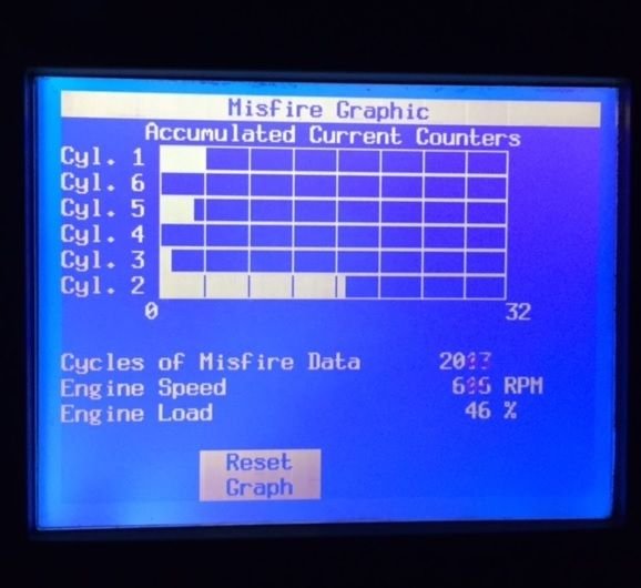

Plug, Wire or Coil for the number 8 cylinder more than likely is the culprit, there is a slight chance it could be a Fuel injector as Bronteck mentioned there is no inline fuel filter. Surprised he didn't pick up a P300 code.
Here's what you would see as a failure on the Tech 2(only difference it would show Cyl 8 instead of 2, and this display was off a 3.6L GM V6)
Hopefully he got it fixed for you.
