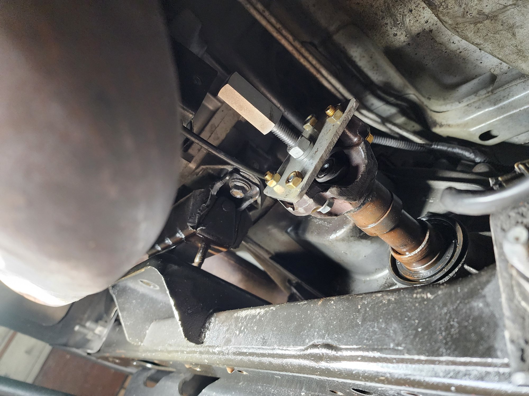

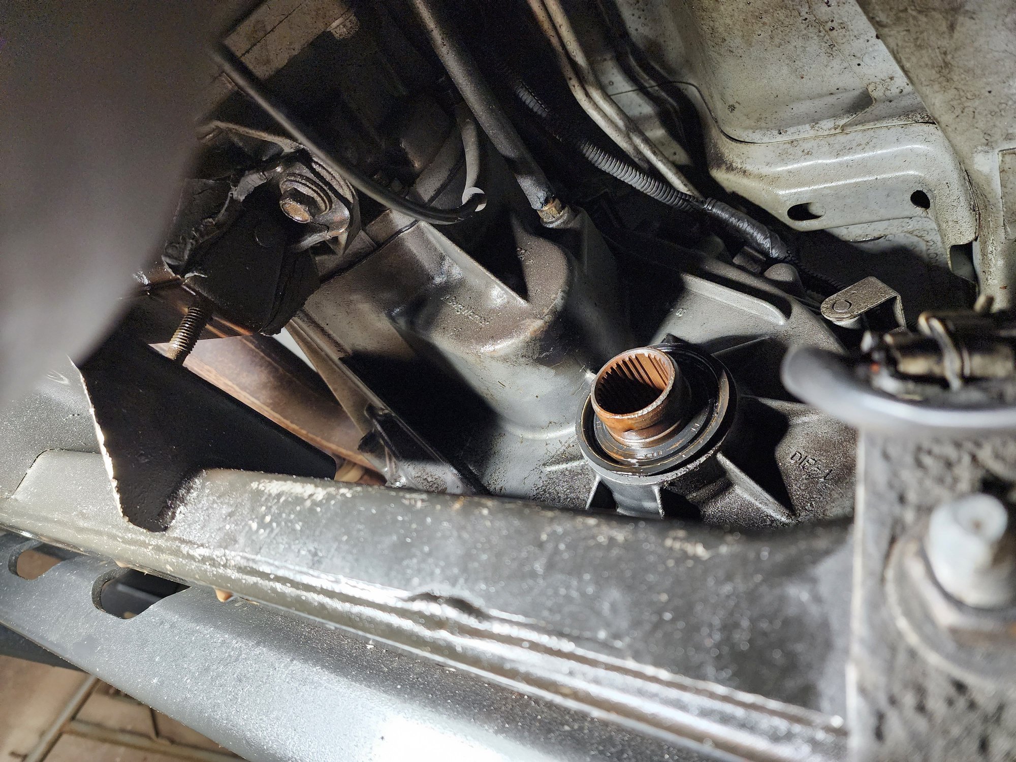

Default Finally got the bugger out!
Made an adapter plate today to attach my slide hammer to the yoke. The splined shaft is finally free from the transfer case hollow bore front output shaft.
Old Jan 9, 2023 | 08:13 AM
calif phil's Avatar
Posts: 2,311
From: Kansas
Good job, Slide hammer plate is a great idea.
