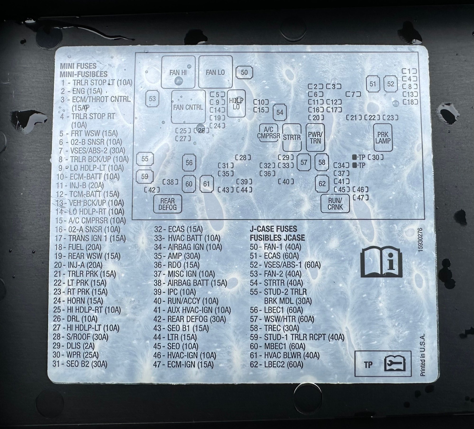

What could I be missing? Any help would be greatly appreciated. Under hood fuse panel photo below.

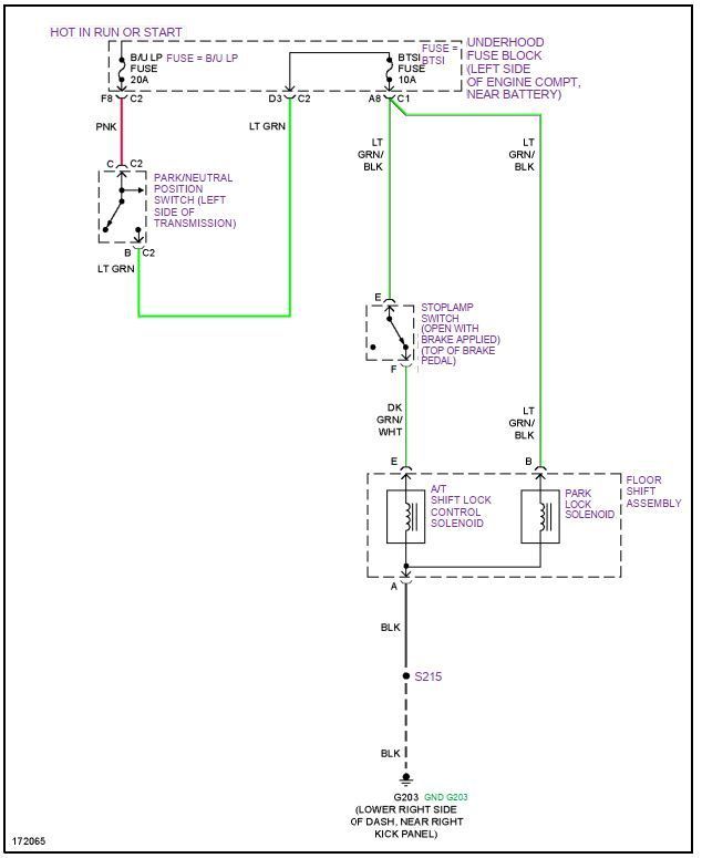

Must emphasize I've no direct experience with the shift solenoid, so not 100% sure, however it looks like later model years are wired very differently.
Below is the 04 wiring:-

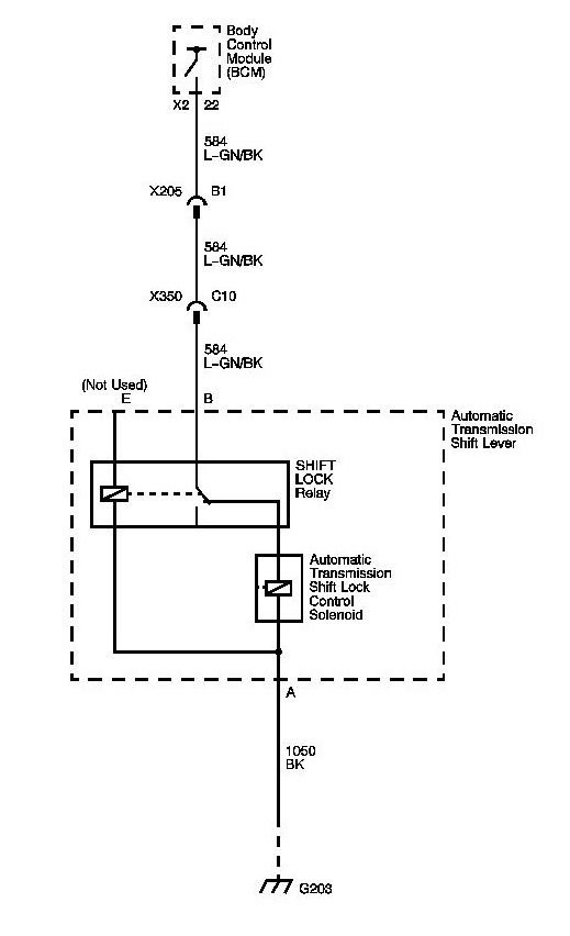

This is the wiring I found for an 08:-
It may explain why there is no BTSI fuse as the BCM now controls the solenoid, but again I'm not 100% confident about this.
It also supports @bronxteck comments.

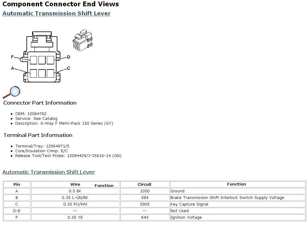

That is a huge help. My apologies for the inconvenience but you don’t happen to have access to which pin on the connector is power and which is ground, do you?
Old Oct 30, 2023 | 10:44 AM
Posts: 3,204
that is the diagram of the colors. light green with black (L-GN\BK) is positive and black (BK) is negative. you need to find where ground point G208 is and check it.

More wiring info:-
10/4. I could swear that I had a pink wire. I’ll double check.
