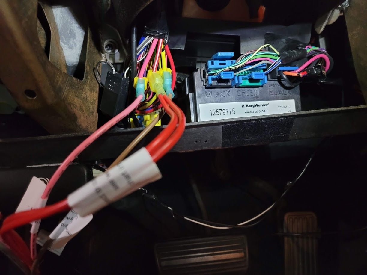

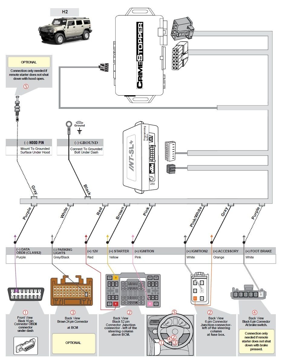

Need help fining the following wires for a remote starter:
1. I'm not sure where the "Brown 24 pin Connector at BCM" is (See attached image).
2, I'm not sure if I have the correct Ignition2 and +Accessory lines (see attached image).
Is it the white and orange wire going to the left that I have the pink and grey wire hooked to?

Couple of things...
The BCM is way behind the headlight switch against the firewall.... That one under the steering column is the transfer case controller.
Those vampire type connectors are terrible. They really cut a bit into the copper wire making it weaker and exposes it which causes the copper to oxidize and get very brittle and over time vibration and flexing will often cause the wire to break there. Do as you wish but I've seen many dozens of broken wires from those over the years. Much better to carefully skin some of the insulation away from the waire to be tapped into and solder the additional wire to it and wrap it up in tape.

Definitely will change those connection now!
I bought a MPC remote starter and they included them: https://shop.mypushcart.com/complete...r-h2-prewired/
I'm still having a hard time finding it, is there a diagram or image that you know of?
Also is the Ignition2 and +Accessory lines correct in the first image, pink and grey wires on left?
Old Dec 8, 2020 | 03:01 PM
Not really sure. I'd have to test them with a multimeter to be sure. I dont have a picture but you have to remove the left dash vent panel then you can remove the headlight and rear wiper switches and you will see the BCM behind them with the connectors facing you.
