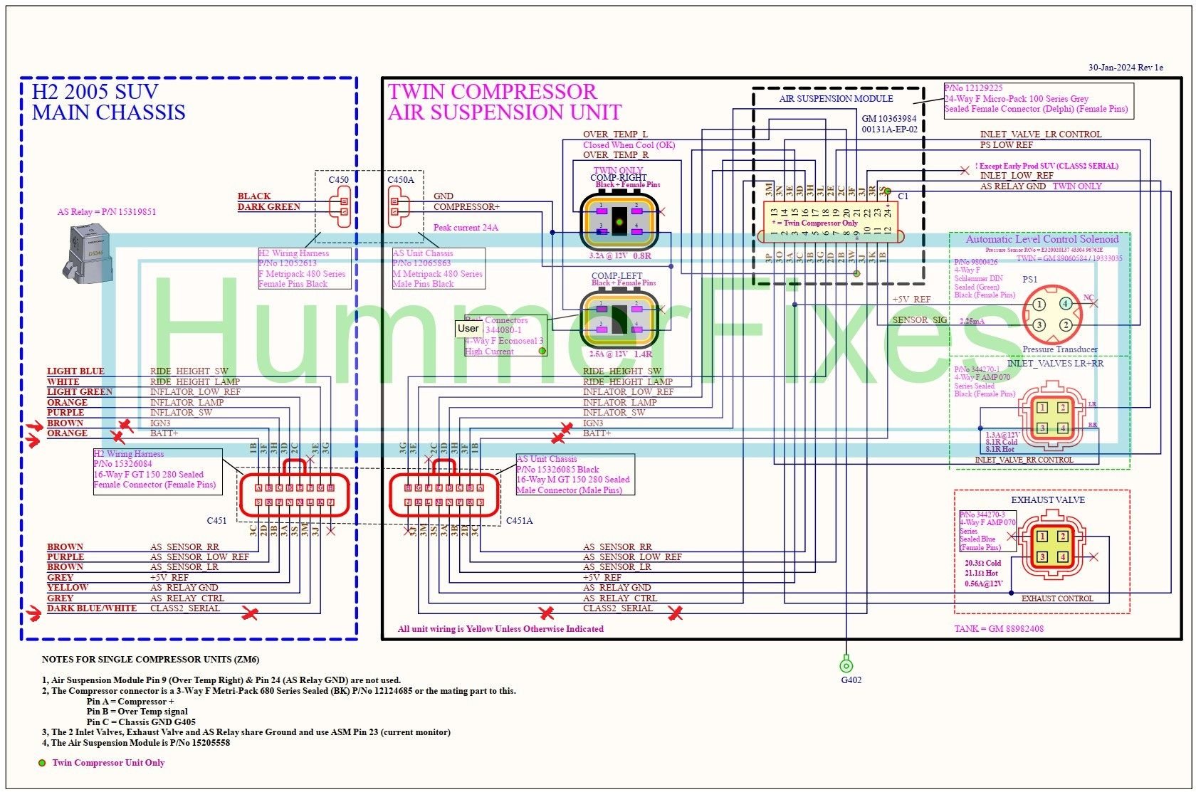

"I think its getting a bad signal from something else"
Below is a wiring diagram for the AS unit showing all connections in and out' you can see the AS Unit is self-contained with only 3 "signals" as you refer to them,
  1. Class 2 Serial - this is the only true signal, it provides comms between BCM and AS-ECU, the ECU controls the solenoids so can't be that
  2. IGN3 - This has two functions within the ECU,
    • used by the ECU to detect the ignition is "ON"
    • provides power to the Inflator Switch lamp and associated ECU control electronics
  3. BATT+ - the main +12V feed, powers the ECU, solenoids, the AS cannot function without it.
It's unlikely and of these these would cause the "clicking" sounds.
Probably the best course of action is to identify the source of the sound :
  1. Left Inlet valve
  2. Right inlet valve
  3. Exhaust valve
  4. Compressor
these are the only electro-mechanical devices on the AS-Unit and so the most likely sound sources.
