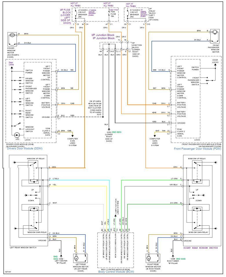

Typically resettable circuit breakers have a bimetallic contact which "bends" and breaks contact when over-heated, once cool the contact is re-made (after time) Since the contact has resistance, current flowing through it generates heat (I²R), so the more current the more the heat. Obviously your breaker is passing too much current, probably in excess of 25A.
1st thing is to identify which door is causing the problem, here is the circuit (caveat - this is for an 04, looks to be the same):-
It's probably easiest to unplug each RHS door switch until the circuit breaker stops heating up, once you've identified which door it is, then investigate further and follow bronxteck 's suggestions.

I am still having the same problem with my passenger side windows circuit breaker. I unplugged the driver side control switch and the passenger side controls and the motor but the circuit breaker is still overheating. Since I have unplugged all of this any ideas as to why my circuit breaker will still be overheating would be greatly appreciated

(drivers door switch is not relevant)
Unplug the Right Rear Window switch as the "RT Circuit Breaker" also feeds the rear RH door.
Could be an issue with the right rear motor and/or mechanism or switch.

Thanks for your help when I unplugged the wire to the switch still had the same effect but when I unplug the wire to the rear window motor the breaker appears to be staying cool once again thank you I'll keep you posted if anything else arise these windows I am going to change the motor out first chance I get and see how that works once again thank you for your help
