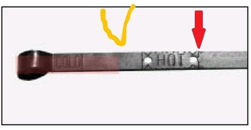

So dealership installed a new (reman) GM tranny in Jan. Due to engine oil leak at radiator (now has a new GM OEM radiator) the radiator was replaced by my mechanic shop. While it was up he noted there was red tranny fluid dripping from where the tranny meets the transfer case. He told me I needed to have it checked. Out of curiosity I checked the fluid level after getting home with it hot. It was showing about an inch above the HOT cross hatch area!! So I used my oil extractor and sucked almost a quart out of it to get it down to the cross hatch area per owners manual instructions. Spoke with my mechanic and he told me there is a pressure relief valve on the top and it was possible if it was overfilled the drips could be from there. Laid a painters cloth and white towel down on the garage floor to see if it keeps dripping or "leaking" (if indeed it blew the rear seal from being overfilled). To date no drips or sign there has been any additional leakage since it was cleaned. So this morning I checked the fluid level 'cold' per manual. Pic shows level I had. Not sure if cold level stops just after the word cold or is the area between line at the word and the bottom (left) line just at the XXHOTXX area. You can see where it was today in the Pic - at yellow arrow. I'm suspecting this is OK, Yes? Yes, gauge shows good "normal" temp when running.
TIA.

Yes, I checked it twice 'hot' on different days following OM instructions - after a couple local trips of about 16 miles then parked in the drive. Both checks seemed to be in the HOT area or just above it. Hard to tell as the stick gets "splash" on it while it is running for the hot check. So I wanted to do a cold check after it had sat a few days, again, IAW the OM. Just looking to verify the "cold" area on the dipstick is any area below the checkered HOT area.
Best to check running at OPERATING TEMPERATURE, should be within the HOT hash marks(both sides of the indicator). MAX (red arrow):
