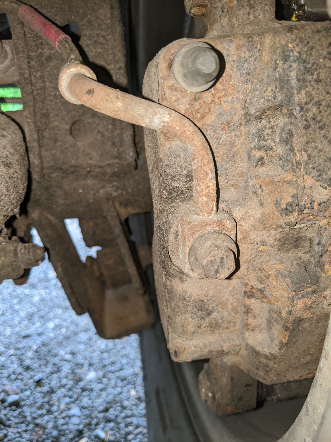

What MixManSC says about air-rising makes sense.
This is a view of my 2005 LH rear caliper yours may be similar, did you change your hoses too?
Doesn't look like there's an alternative bleed screw position.
You might be able to use hose-line screw to bleed out some of the air, I've seen that done before, it might help (MixManSC method would be better)
