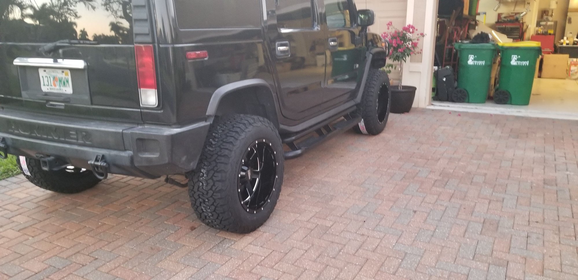

The only thing I would suggest is considering something other than a 17" wheel. Tires are some what limited for 17". Spacers require longer wheels studs and are somewhat undependable in my opinion, you would also need hubcentric spacers for the H2 and the further out your wheels go the more stress you will put on the hub bearings and other suspension parts.
These are pics of my old H2. Black grill that I paitend with plasti dip, it lasted a long time and the wheels were 20X12 -44. I thought they were perfect.

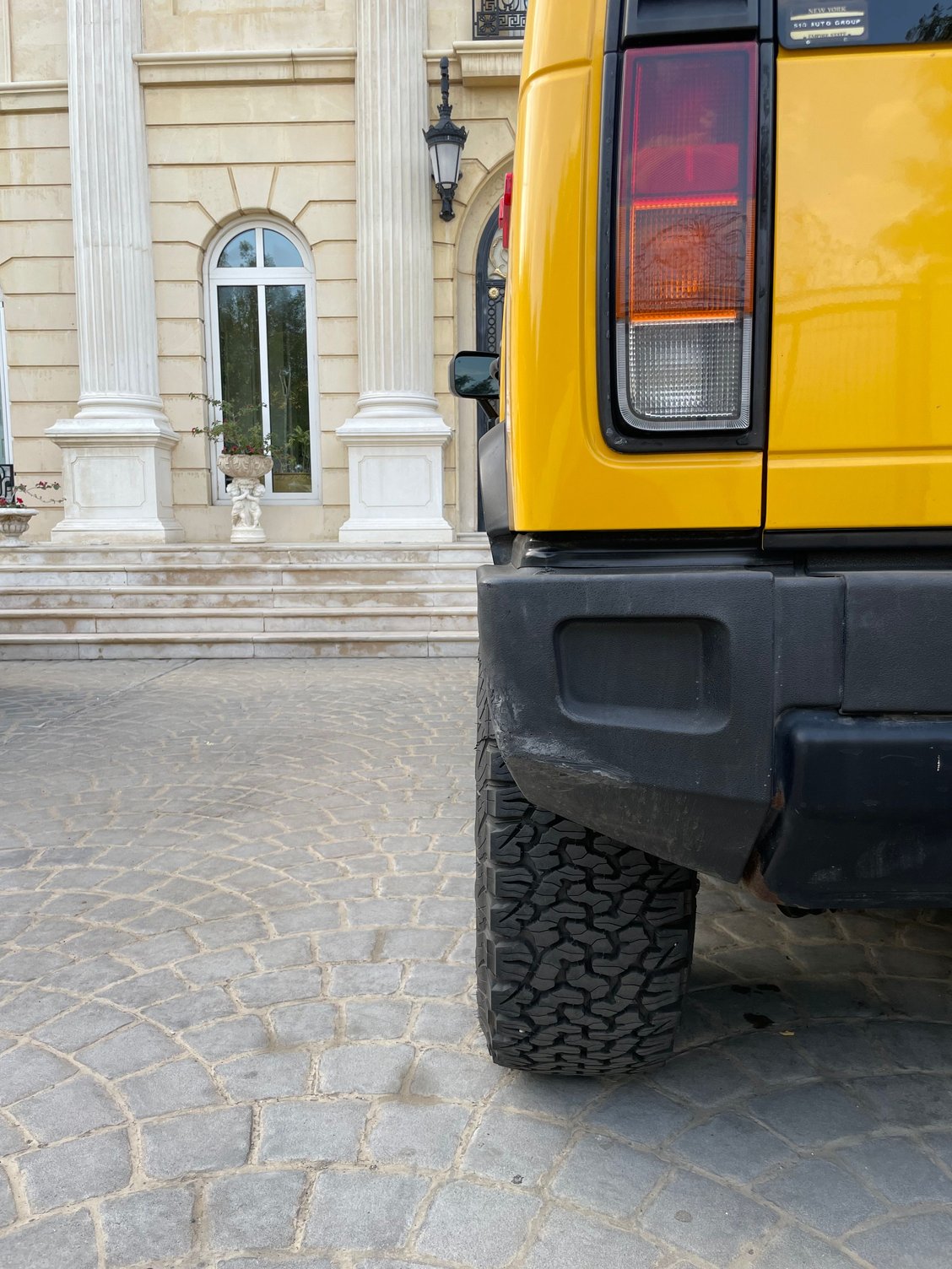

Because its my daily, and tires are new I prefer sticking to 17s + comfort. So going with 9.5”, 0ET & 5” bs will only push the poke out by 24mm.. barely anything. And im looking for more aggressiveness look.. just thinking if i go with like 0.5-1” spacers (hub) like the H&R, is that possible?
heres how my stock sticks out now

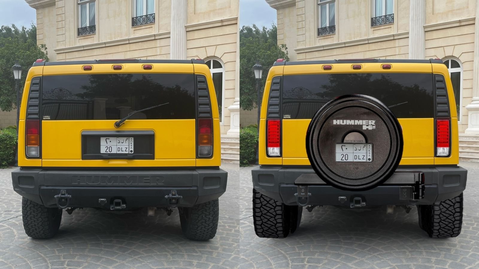

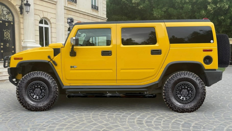

So I did the opposite of what I planned.. ended up ordering wheels & cheap out on the lights lol. So yes Gavin, Wheels over lights haha. here's what I ended up with:
  • Wheels: Black Rhino Primm (17x9), I requested to replace the brass bolts with black. ETA delivery mid-Feb. (render photo below)
  • Light bars: Lasfit 52" roof & 32" grille
    generic generic
  • Headlights: generic amazon inc. H4 to 9007 adapter-
    Link Link
  • Fogs: generic amazon also -
    Link Link
  • Spare tire carrier: still looking in junk yards, cause shipping that part to me will cost prob 2x
render Primm wheels

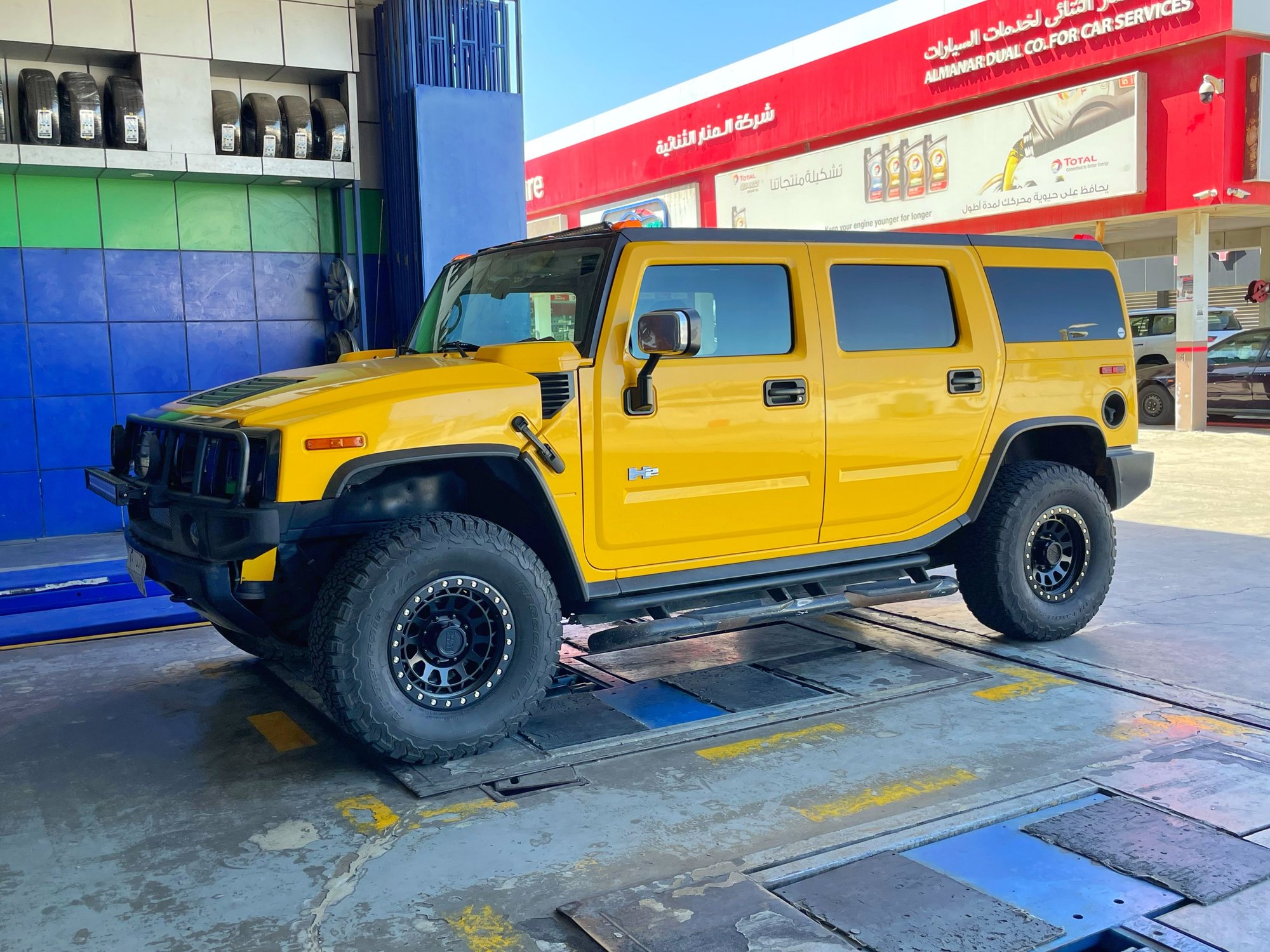

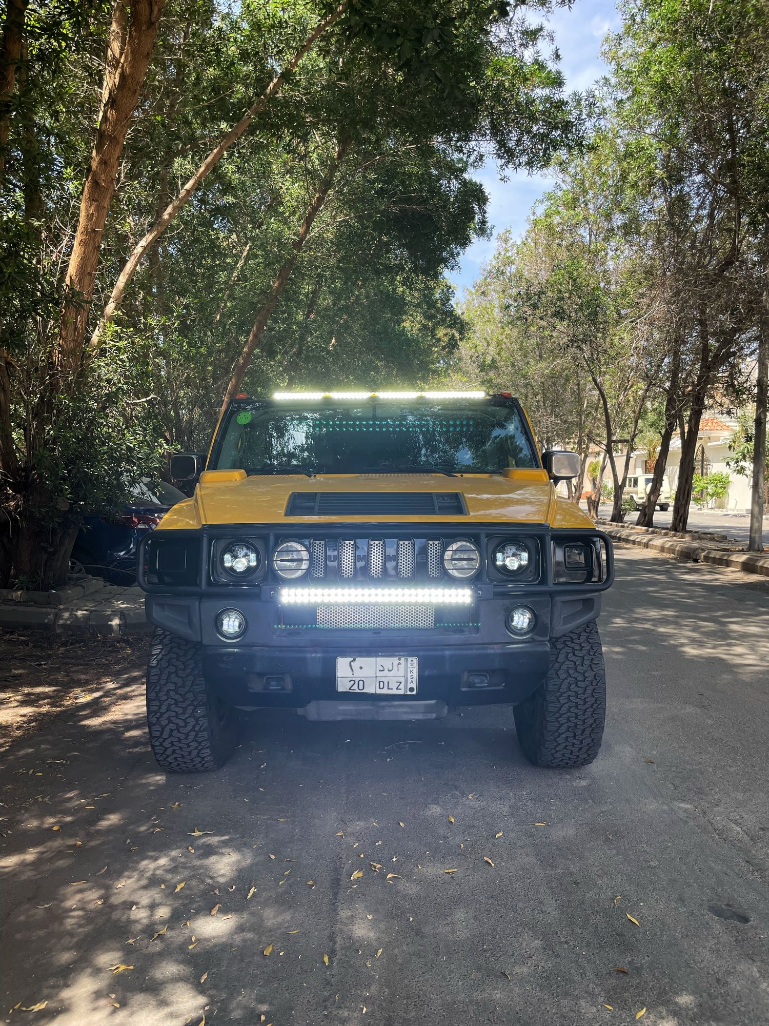

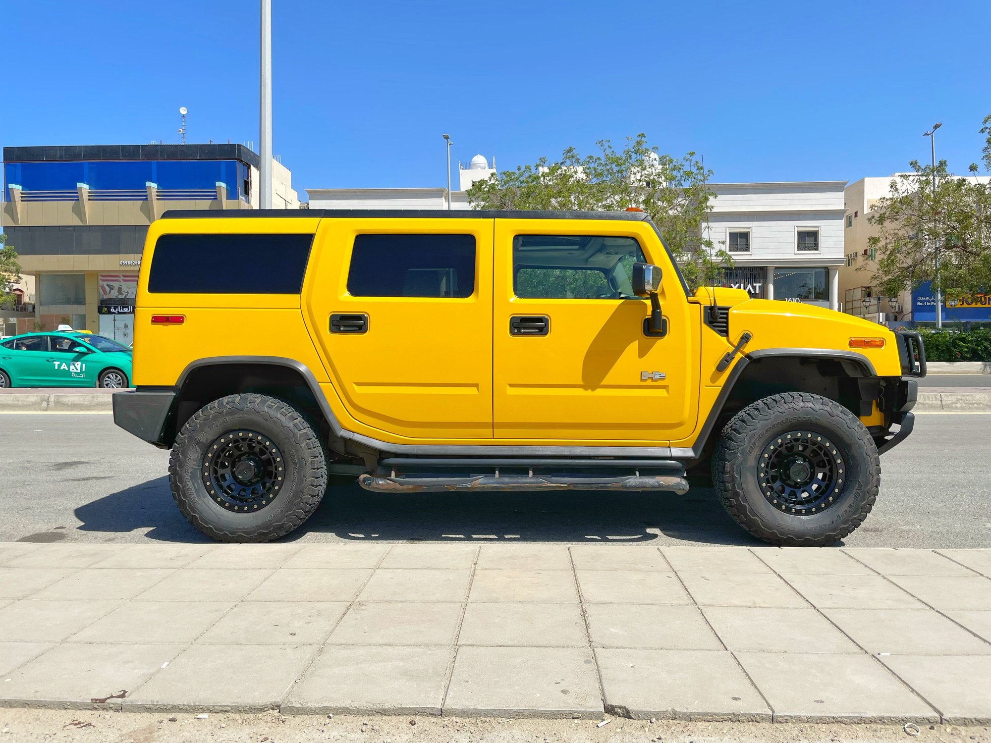

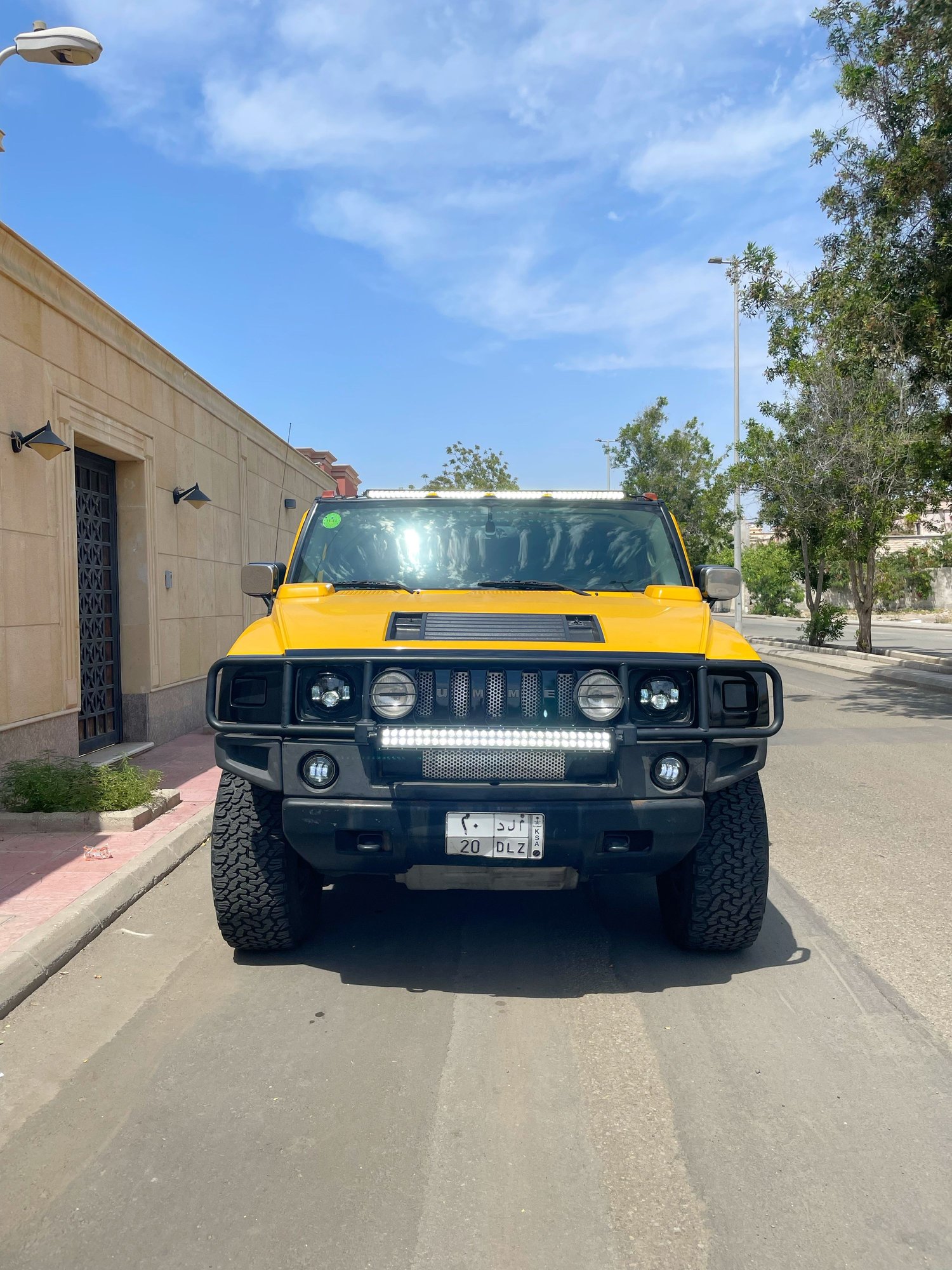

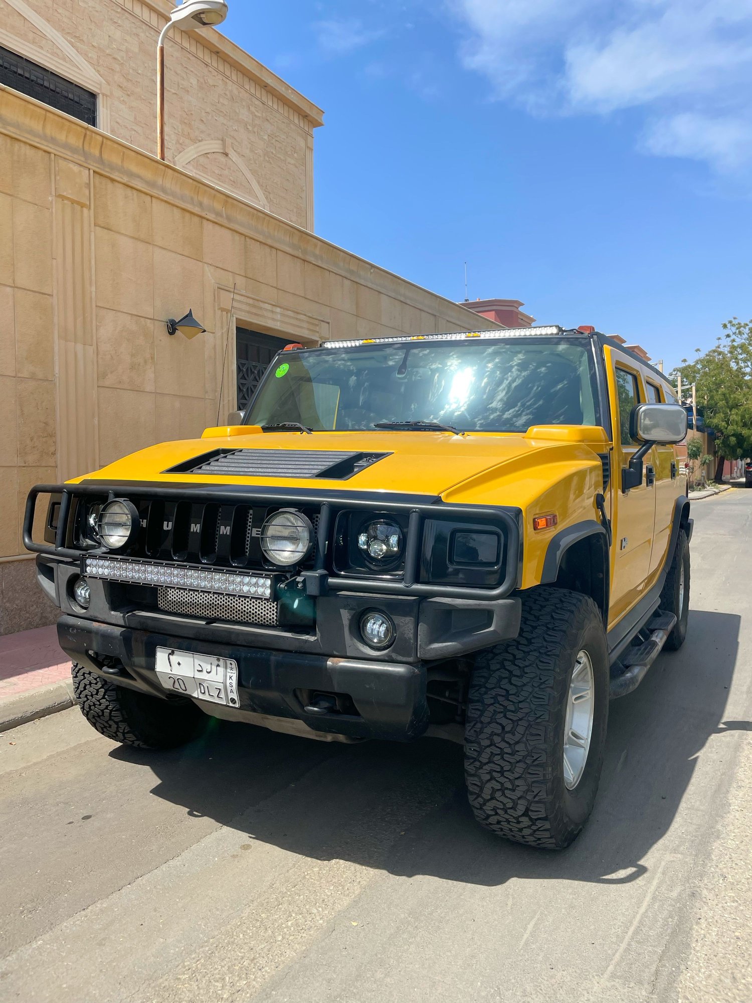

ALL DONE, HERE IT IS!

Looks nice, now spray some color on the side steps and front smash plate.
