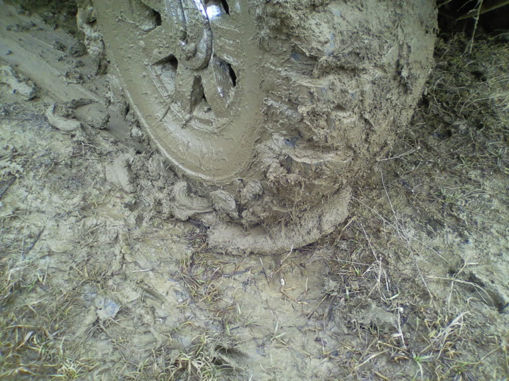

This one is a good one so you can see how heavy the clay is. Even the Boggers wouldn't clean out too well. My truck doesn't have the power behind it like yours does though.

LOL.... you know it's nasty crap when Boggers look like racing slicks....
