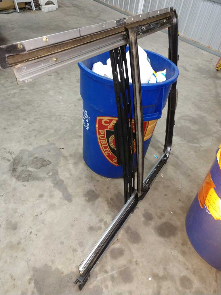

I have a water leak coming in to both sides of my front A pillars, the usual leak I thought. After sealing everything twice over the last year I have finally found where its leaking from..............On my sunroof track (both sides) there is a small square with an opening that water drains directly down to my headliner and into the corners of the A pillars. It seems as though there is supposed to be a seal or something that is screwed down in that area, as both sides have a screw hole there. Attached are some pic's, pretty self explanatory.......can someone please verify this on their H2 to see if there is something there?

Those holes are normal. I wish I had taken better photos when I have mine out. Anyways under those holes (and it extends a but further out) is a plastic tray that is the rain gutter which runs the full length down each side and along the front edge. At each back corner and each front corner are nipples that the 4 sunroof drain tubes connect to.
If water is coming in from the sunroof it has to be one of the following:
One of the drain tubes have come off one of the nipples or is not sealing to the nipple.
One of the drain tubes are not flowing freely or totally clogged.
One some sort of blockage sitting in the gutter blocking one of the drain nipples.
The plastic gutter is cracked or possibly one of the nipples are partially or totally broken off.

Sounds to me like the plastic gutters are missing. If I stick a small screwdriver down into the square hole it presses my headliner down. This makes sense, as I think the previous owner had the sunroof out as my sunroof has a small vibration above 70MPH, which means it wasn't "programed/adjusted" correctly after replacement.

This was the only photo I took that shows the entire frame. You can see the black part (dirty in it) that is the gutter. That part is not directly under the silver track. That hole in the track does go directly to the headliner which is normal....
Also attached are the adjustment instructions for the glass.
