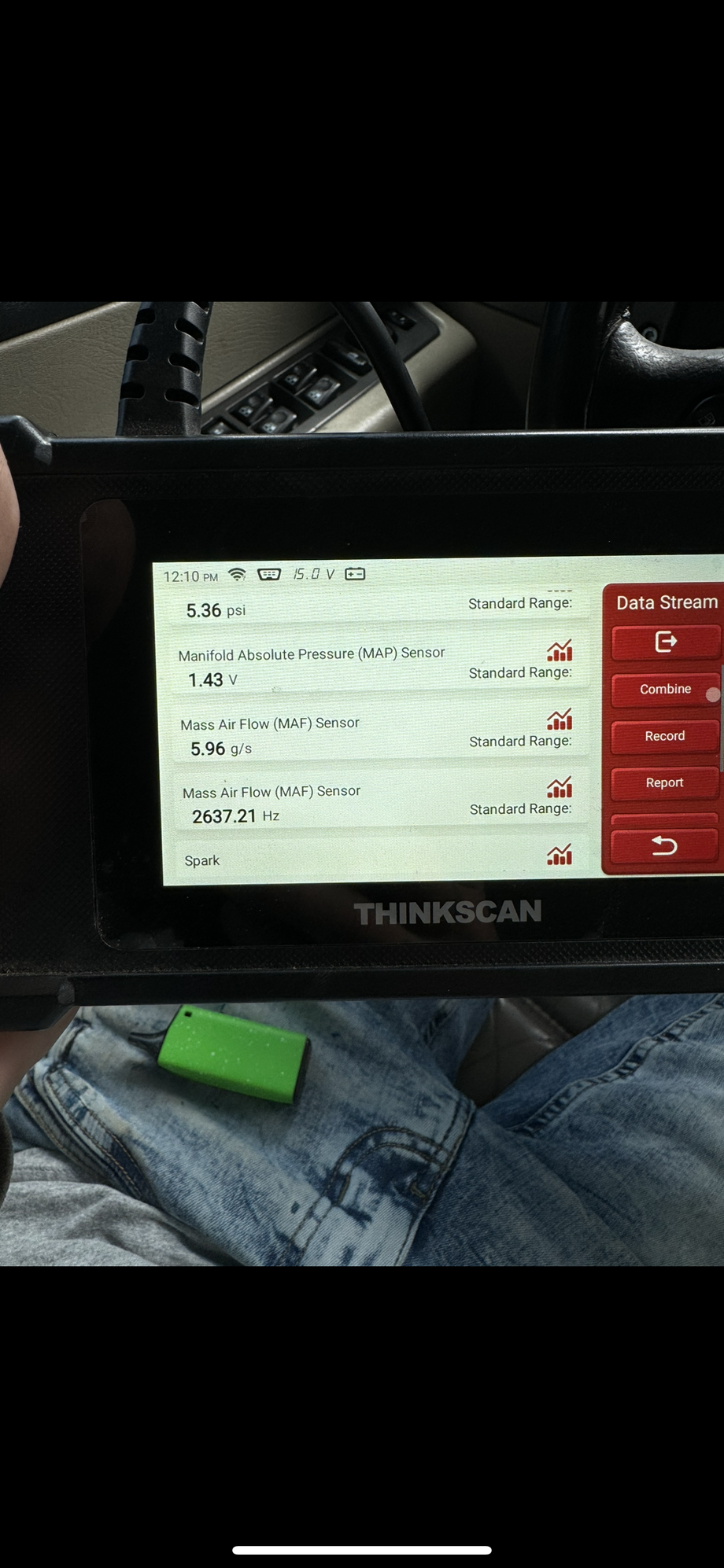

here’s maf reading at idle

I checked out my ignition timing advance for cylinder 1, range says between 5-30
at only 2000-2500 rpm I’m reaching high 40s. Shouldn’t the knock sensor retard the timing if it gets high enough to spark knock? Or does the crank sensor control the timing for these?

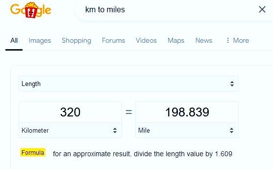

Originally Posted by Bummer11
The engine has 320km or 80k miles on it.
Old Sep 25, 2024 | 05:39 PM
Bummer11's Avatar
Joined: Sep 2024
Posts: 15
From: Nova Scotia
thanks for the correction, I must have made a typo/mistake clearly when I did a quick km-mile conversion online.
I wish you could help me figure out the problem I’m having with my truck with how quickly you found the problem with my conversion lol
