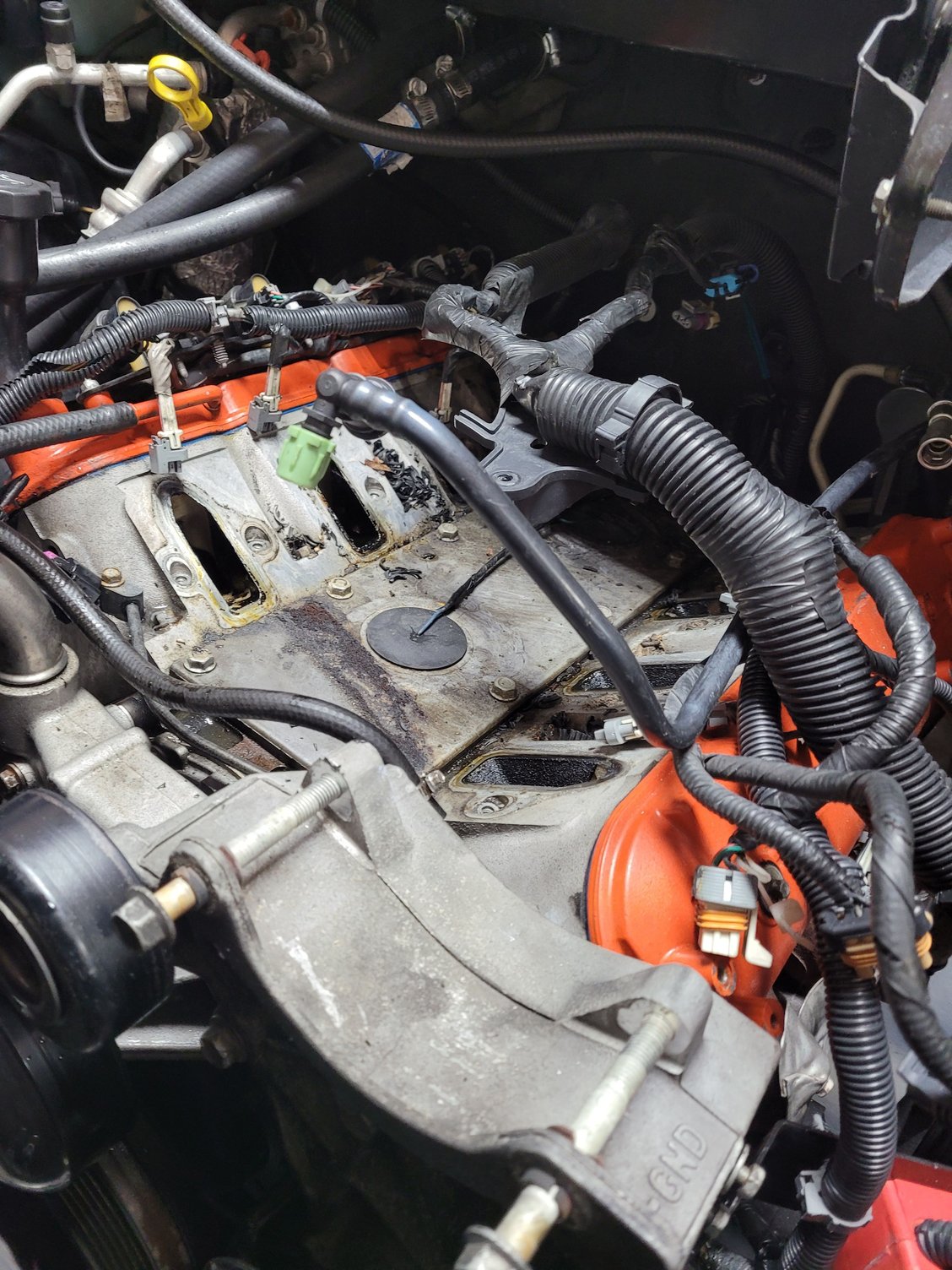

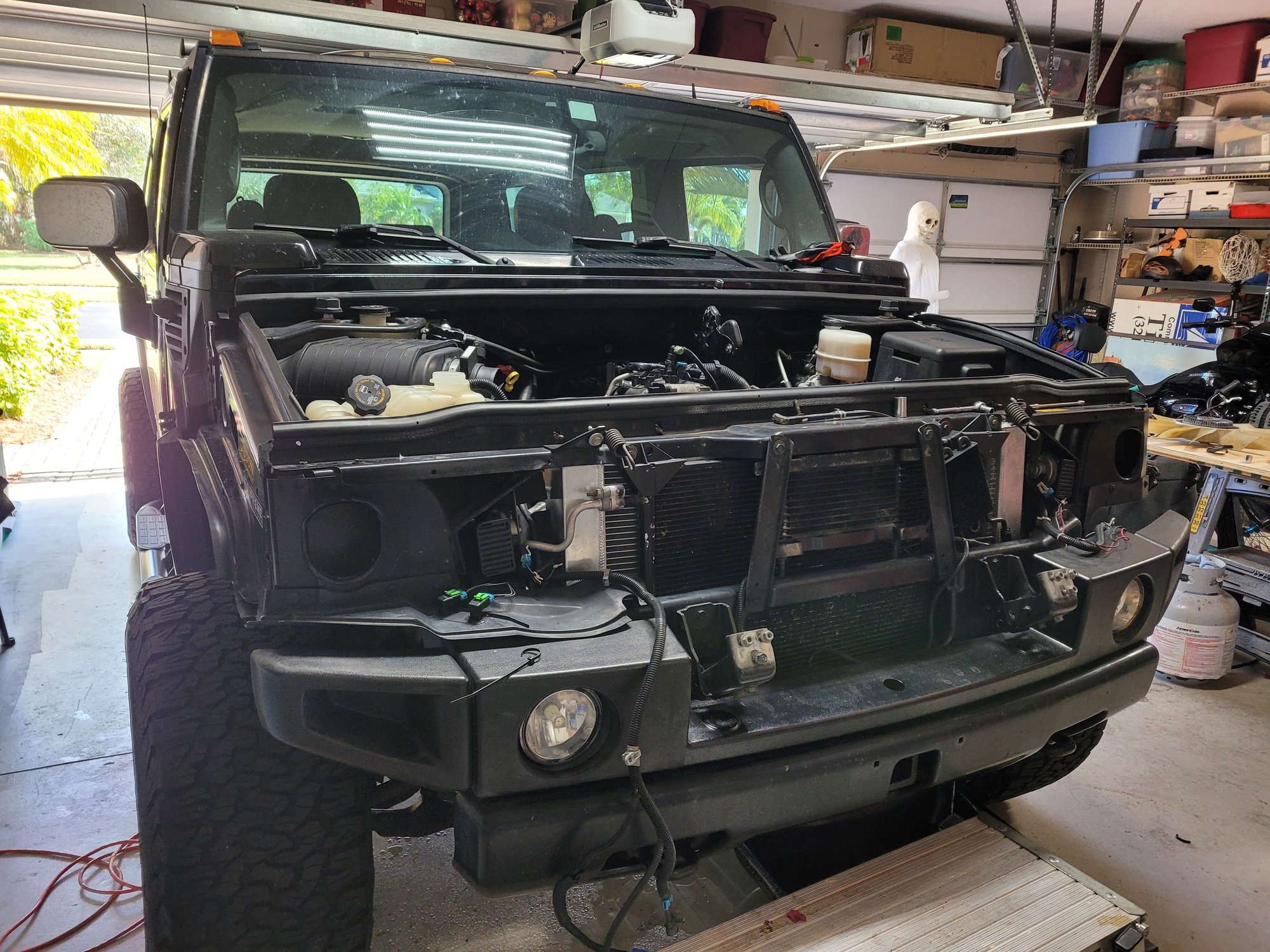

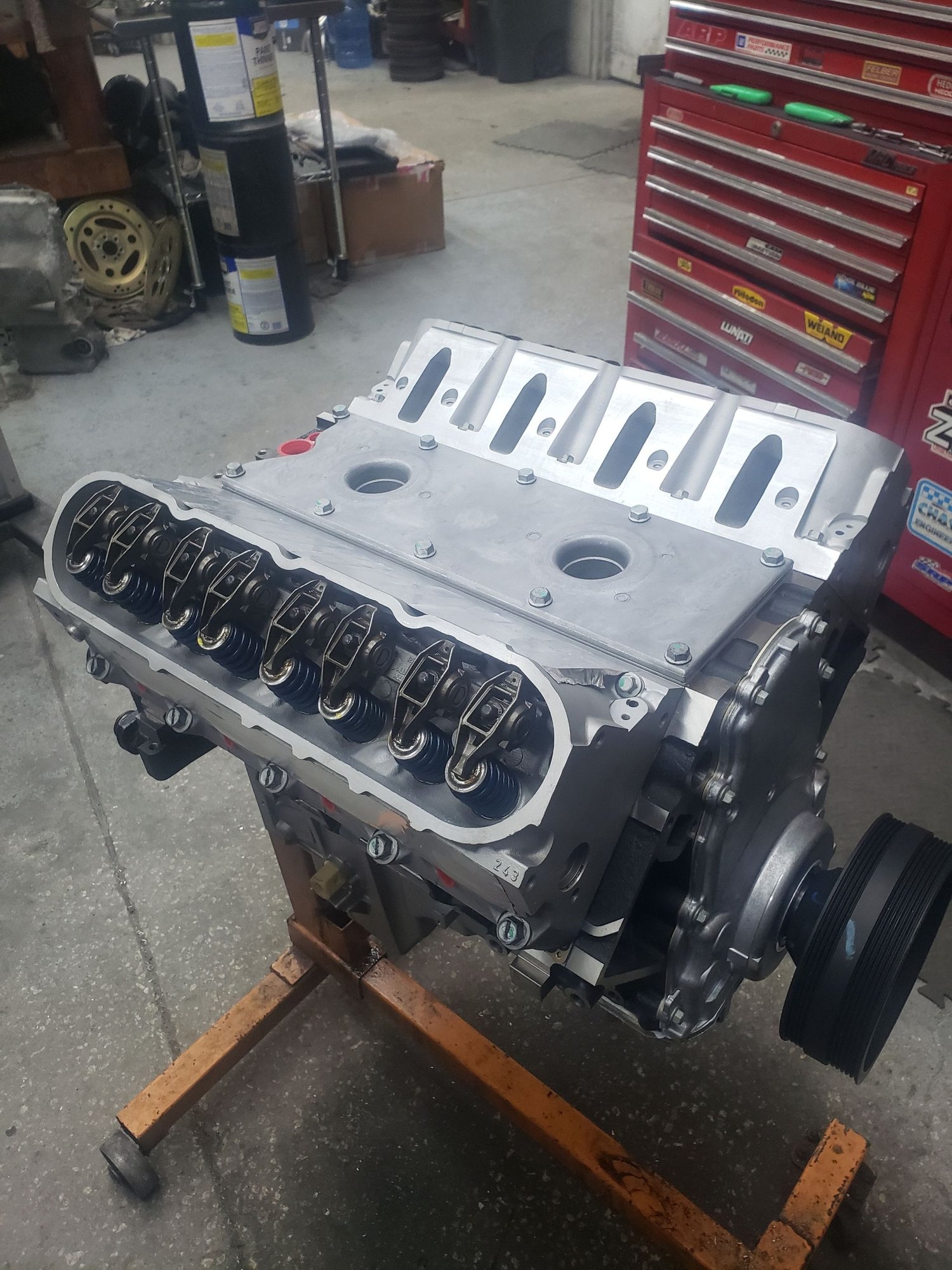

This is the base of what I started with: https://www.chevrolet.com/performanc...nes/ls-364-450
I wanted to keep the cathedral port heads so I swapped the square ports that the engine came with with some fresh 243 heads. They have a 5 angle valve job, mild porting and a set of GM blue springs. These heads will also bump the compression up to near 11to1.
The cam that it came with is a LS6 cam, which is not really what the Hummer needs, so I'm waiting on a BTR stage 2 truck cam to arrive later today. This cam will have a killer lope at idle and power will come in early at around 1400 rpm. Specs are 218/218 .553/.553 111+0. Sound clip here:
To top it off I have a TBSS intake with 50lb injectors and a 90mm gold blade throttle body off a LS7 Corvette.
I'm debating a baby stall converter but haven't made my mind up yet. It would be fun that's for sure.
I'm trying to learn my way thru HPTuners so I can get a good start up tune. The truck was tuned before but I don't know if that tune will work with this engine. I'm guessing this new engine will be in the 420-450 hp range without having to spin it too hard.
IN progress pics below. I'm not working on it too hard. I won't have all the parts in until the middle of next week.
Tim
