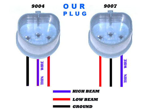

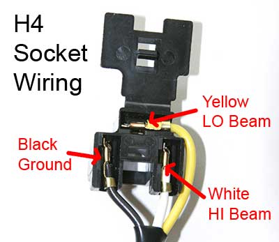

I'll throw in my 2 cents for you as I just went through this. First, the lights are awesome!
Hard to find also because the manufacturer is always looking for "new and improved" marketing ideas. So boxes have changed but not the baseline specs. You are going to have to go through a process of elimination by writing down the specs and check lights that look somewhat like them. It takes awhile but they are out there.
Forget about compatibility. Any 7" lamp will work with some mod's which are very easy to do.
You absolutely need the adapter from the H4 to the 9007 or you can make your own.
You just have to trace the wiring because the grounds are located in different positions. 6 fuses later, left right and hi lo, I figured this out after I tried splicing my own. White is the international ground color so I thought what the heck. Wrong. I should have listened to Mixman.
Right now, I have to take them back out because I have then in upside down. Its a beautiful patern, just upside down. I had no instruction in the box off any kind. I attached some pics or at least tried to. I cant seem to post pics or just dont know how to do it very well.
T
Attached Thumbnails Led lighting-9004-9007-hid-plug-pin-polarity-pattern.jpg   Led lighting-h4_socket_wiring2.jpg   Led lighting-4656toh4conversion.jpg
