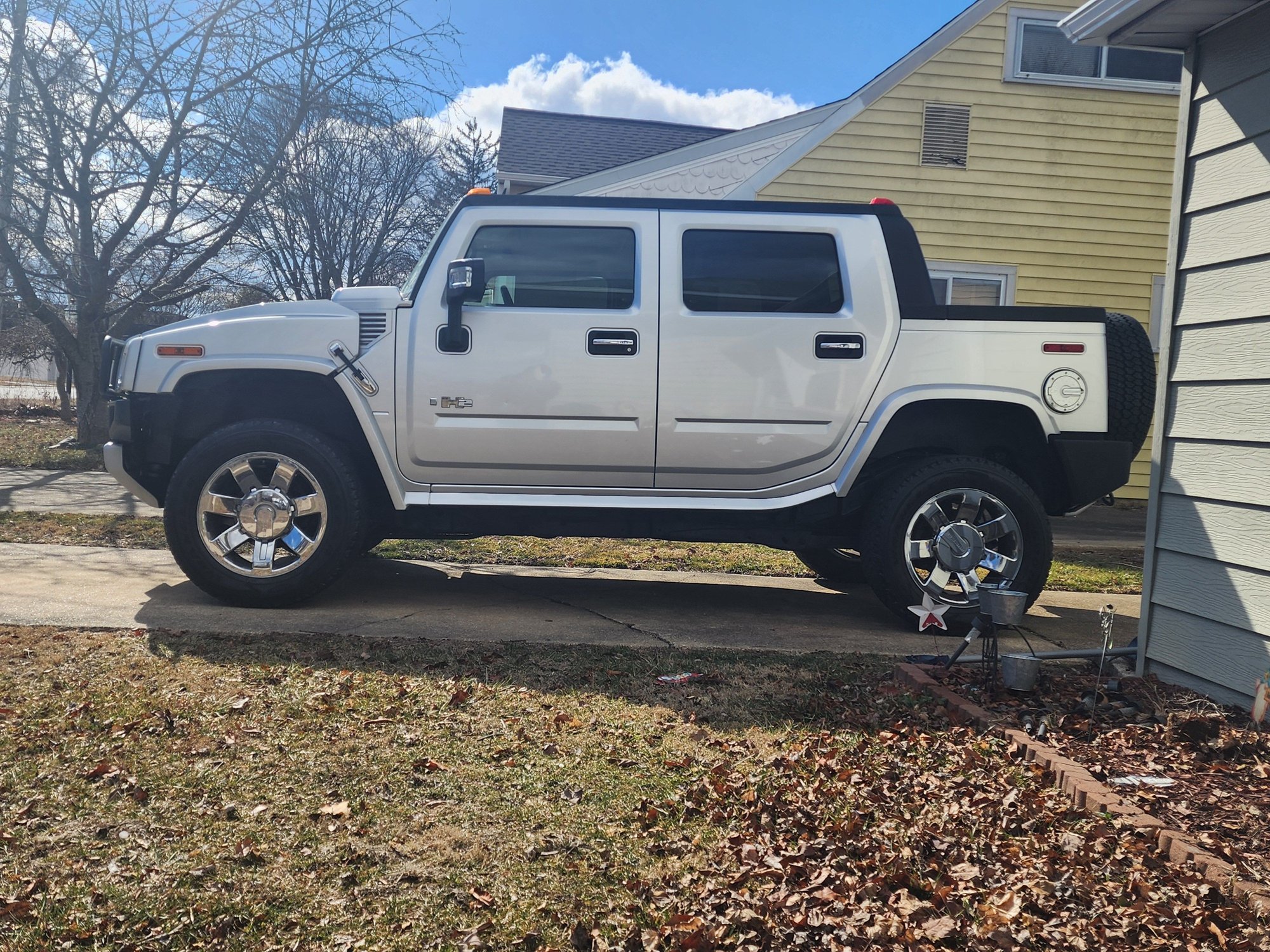

I appreciate the feedback. The wheels/tires seem like the hardest thing to put on this Hummer and the most expensive to really bring this vehicle to life. I wish I never got rid of my 05 SUT. The previous owner(s) already had a lift kit on her, with dual cat-back exhaust, 38x13.50R22 inch tires. This 05 HUMMER took steep hills, bridges and overpasses like a champ. So, I'm not sure if the previous owner re-geared her or not. This is my first project H2 I'm trying to trick out from scratch.
05 HUMMER SUT
05 HUMMER SUT

Good looking truck
Neal

Default This is what I have now

I got the post by Jack America and yours mixed up, didn't look at who posted when I responded, reason for the UCA and shock comment.
You've got a good looking 09 H2 there,
