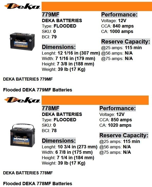

correct me if i am wrong but a larger battery will have a higher reserve capacity and higher cca right?
i was wondering what are the negatives of lets say running a group 78 side post with 800 cca? it seems like i can save $140 if i run a group 78.
regardless if the battery is side or top post, i can just rewire the battery cables and change them to top post no?
however i am open to running something larger too but it cant be near obselete like a group 79.

A group 78 will work, just buy a quality one like the Deka brand mentioned above, I would skip cutting or splicing the battery cables and just purchase the sidepost battery.

Group 78 is smaller yet comparable performance with Deka ultimate. Depends on the battery manufacturer and line you choose.

correct me if am wrong but it seems like the group 78 is smaller then the group 79 but has more cca?
i thought the bigger battery will have a larger cca and larger reserve capacity or does a bigger battery only have higher reserve while cca is dependant on quality and composition etc?
You are correct, (specs above are incorrect, from a retailer site) If you go to the EastPenn link above, you will get the actual specs:
