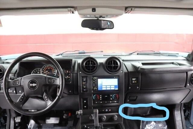

So I live in the cold and I felt the bottom right side of the passanger side under the dash getting super cold to the point where no one could sit there and I just saw a video and saw that there is a cover for that side and I guess my Hummer H2 05 did not come with one so really need help looking for this blower cover? Here is everything I can find that looks like it. Need it asap it is -10 degrees outside

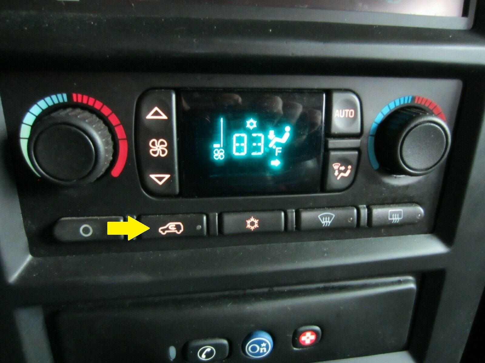

Do you know what this button is for?:

No? It has to do with that cover or?
Old Jan 31, 2022 | 02:00 PM
Posts: 9,018
No, the air recirculation button cuts off the outside air to the inside.
Old Jan 31, 2022 | 03:31 PM
Yours came with it. It is missing though. Those are commonly called a hush panel. If it is getting super cold on that side maybe a blend door actuator is gone out which will cause one side to blow hot while the other side blows cold air which is a common problem. The recirculation door could also be stuck open - the blend door actuator for the recirc door is a big pain to get to. While there is a recirc button as shown above, that does not function in certain modes like defrost - in some modes recirc is automatic to reduce condensation.
GM part number is 15244515 - I'm pretty sure the same one is used in Escalades and some Tahoes so should be easy to source. Some of those use the same air distribution box up under the dash which is what those covers are designed to fit and attach to.

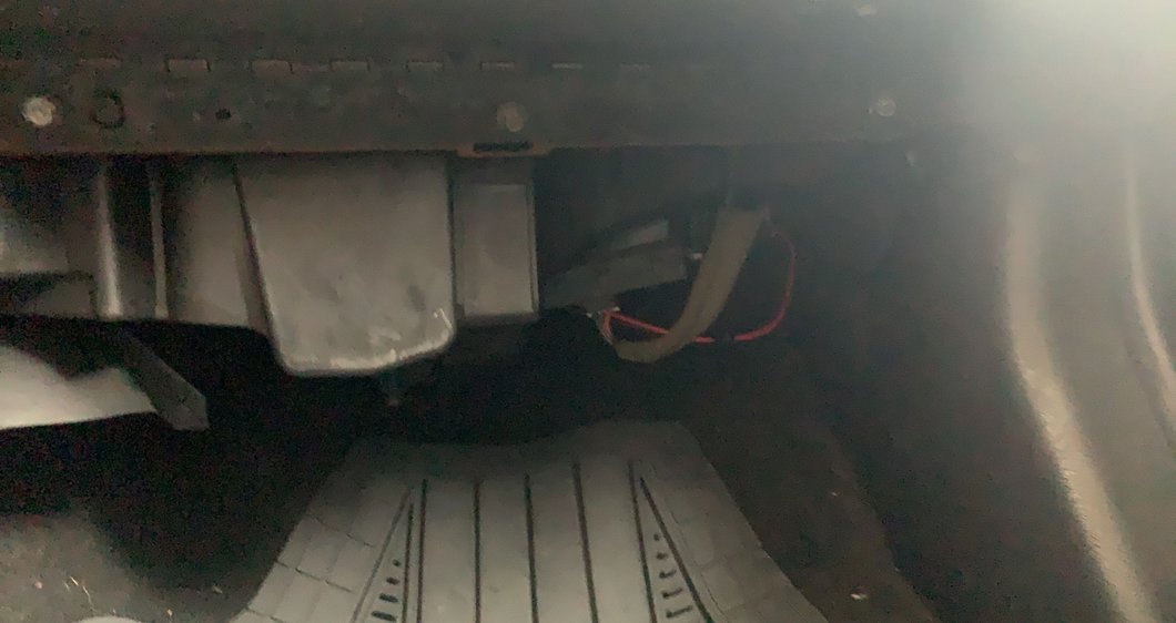

This is what mine looks like and it does get colder and blows colder air as the speed goes up. The vents blow hot air on both sides it’s just the bottom there blowing cold air.

Ok, that is a better photo.
The blower housing looks to be there. So it is NOT a blower housing issue.
But the valence trim cover should be there to prevent you from kicking the wiring, etc.
And I believe that one does NOT have anything to do with heating.
Strictly cosmetic and functional to keep feet off the stuff under the dash.
Someone was under there to do something, and did not bother to replace it. You can find one from a wrecker or elsewhere.
You have a different problem. Did you check the HVAC controls like I suggested?
If you set them correctly, you could have 15C (~60F) coming on one side, and 32C (~90F) on the other side.
As per your photo, WHY is your vehicle so rusty INSIDE? Was it ever flooded?

Hello Tried making both degrees same doesnt do anything to stop the cold coming from the feet but I did record a video of the whole housing could it be possibly coming from that corner? feels more from the top. Here’s a video since i can’t upload mp4s on here
