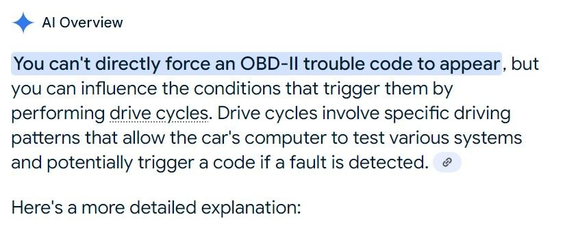

It is not possible to directly "force" OBD-II trouble codes to appear. OBD-II systems are designed to detect malfunctions based on specific operating conditions and parameters, not to be triggered by external commands. However, you can create situations that might trigger a code by performing specific driving maneuvers or testing components known to be problematic.
Here's a more detailed explanation:
Understanding OBD-II Monitors and Readiness:
  • OBD-II monitors:
    The vehicle's computer (ECU or PCM) uses monitors to check various systems for malfunctions. These monitors run under specific conditions, like temperature, speed, and load.
  • Readiness codes:
    When a monitor completes its self-test, it sets a readiness code to "ready". These codes are used to verify that the vehicle's emissions control systems are functioning correctly.
  • Clearing codes:
    When trouble codes are cleared (either with a scan tool or by disconnecting the battery), the readiness codes are also reset, meaning the monitors need to run again to set them back to "ready".
  • how to force obdII trouble code
    An OBD-II trouble code, also known as a Diagnostic Trouble Code (DTC), is generated when the vehicle's onboard diagnostic system detects a malfunction within a specific system or component
    . These codes are designed to help mechanics and vehicle owners identify problems that need attention.
    The check engine light on your dashboard illuminates to indicate that a trouble code has been stored in the vehicle's computer. The specific code corresponds to a particular issue, allowing for targeted diagnosis and repair.
    Different systems in a vehicle can trigger codes, including:
  • Engine System: Codes related to misfires, fuel system issues, or air intake problems.
  • Emissions System: Codes related to the catalytic converter, oxygen sensors, or evaporative emission control system.
  • Transmission System: Codes indicating problems with the transmission's operation.
  • Anti-lock Braking System (ABS): Codes related to the ABS components or function.
  • When a check engine light appears, it's recommended to have the vehicle diagnosed by a qualified mechanic. They can use an OBD-II scanner to read the stored code and determine the specific issue. Attempting to diagnose or repair complex vehicle problems without proper knowledge and tools can potentially worsen the issue or create safety hazards.
How to Potentially Trigger a Code (Not Force):
  1. 1. Drive Cycle:
    To force the monitors to run and potentially trigger a code, you can perform a specific drive cycle for your vehicle. These cycles vary by manufacturer and model, but generally involve a combination of cold starts, idling, steady speeds, and acceleration/deceleration.
  2. 2. Test specific components:
    You can test certain components that are known to cause trouble codes. For example, you could disconnect an oxygen sensor or run the engine with a faulty catalytic converter (if you have access to a controlled environment) to see if a code is triggered.
  3. 3. Monitor readings:
    Use a scan tool to monitor live data from sensors and systems. If a sensor reading is outside the expected range, it could indicate a potential problem.
Important Considerations:
  • Don't clear codes unnecessarily: If you are preparing for an emissions test and the check engine light is off, it's best to avoid clearing codes, as this will reset the monitors and require a drive cycle to complete them again.
  • Consult your owner's manual: Refer to your vehicle's owner's manual for specific drive cycle instructions.
  • Professional help: If you are struggling to diagnose a problem, consult a qualified mechanic.
