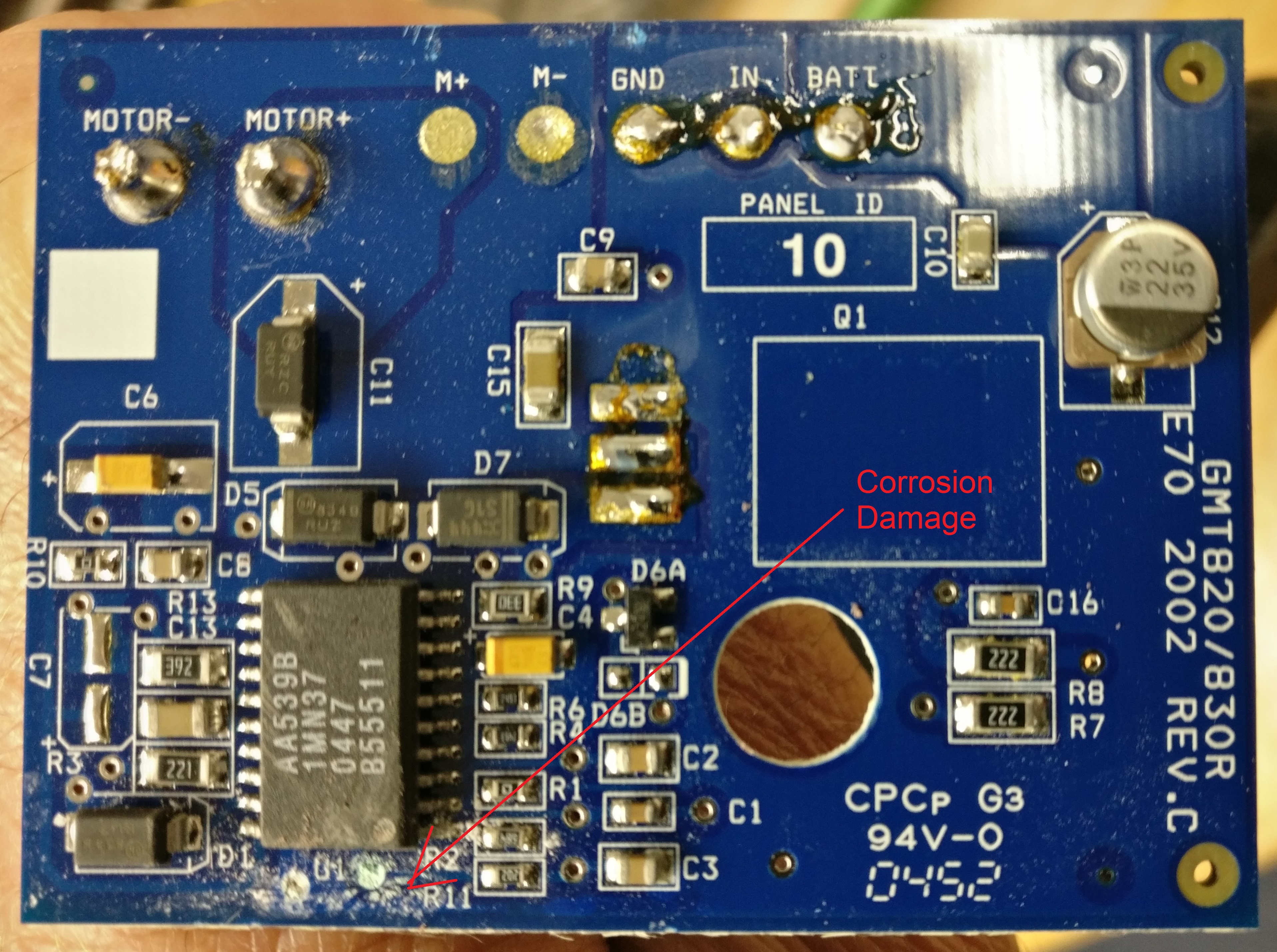

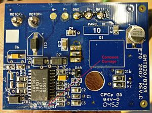

Just thought it might be worth posting as these modules are so rare and mine was an easy fix, could be yours is similar!
The blower motor didnt run, tTook out the motor and controller which took 5 minutes.
Disconnected the motor and checked the controller O/P, at max speed Motor = 12V, min speed = 5V'ish no O/P with the motor connected. Checked the motor on a bench supply, was 100% OK and in good condition.
Pulled the module apart, just 5 plastic lugs and a torx screw in the back (behind the product label) BTW there's no resistor inside!
My module had two faults, a corroded track and a loose heatsink. Repaired the track and used thermal compound + a new insulating washer and it work 100%!
Root cause is condensation causing corrosion. Save some $$ fix it yourself!

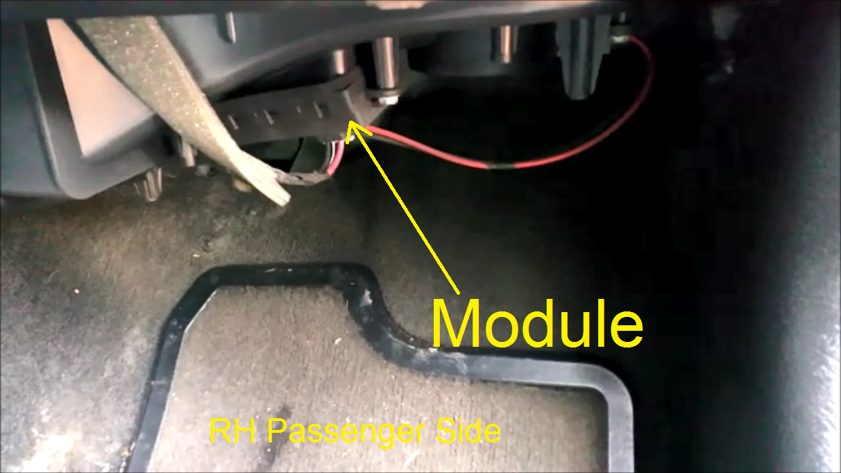

So its the RH Passenger foot-well, just a coupl of screws to remove the panel, this will expose the module ( 2 screws)

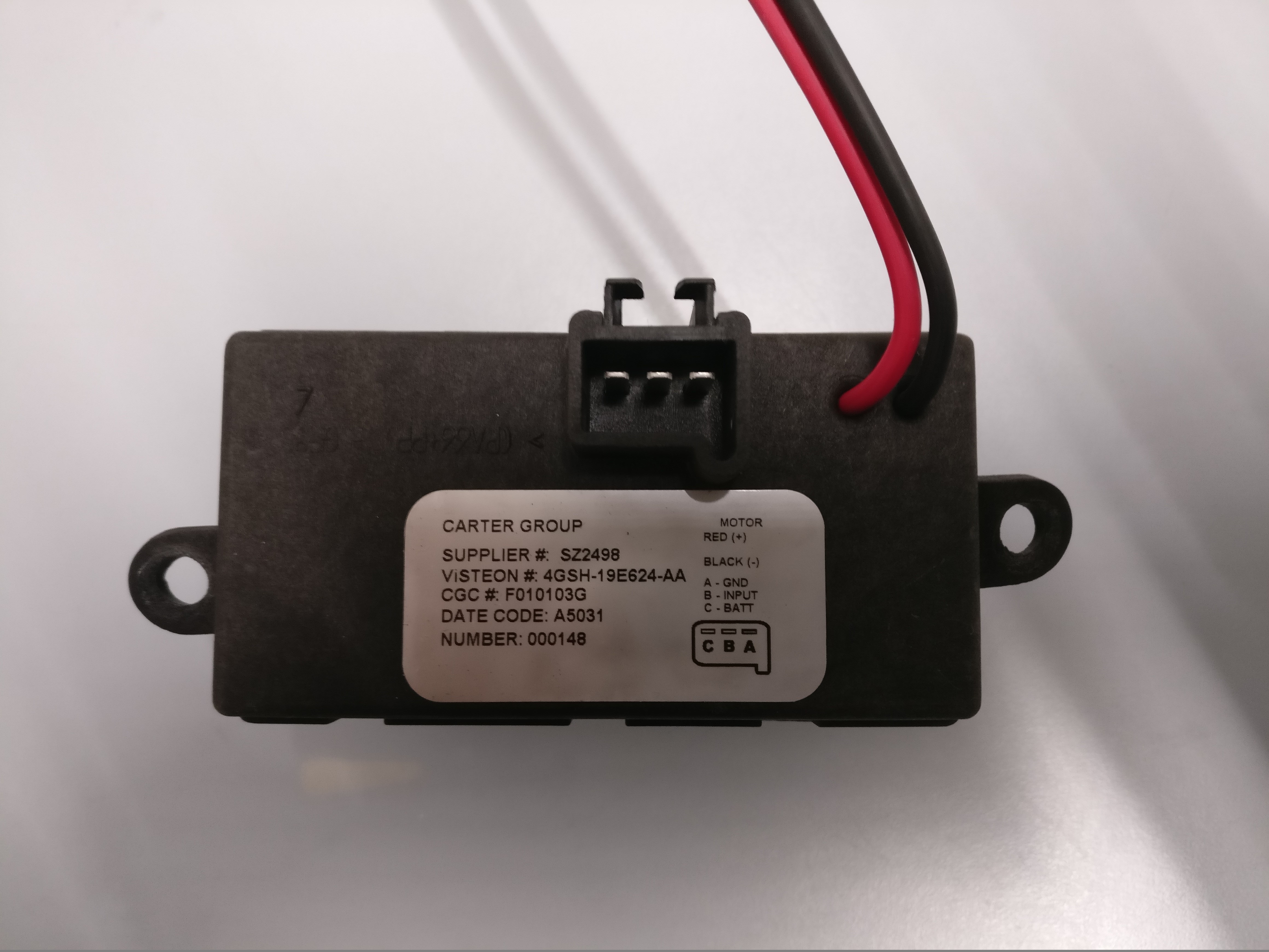

Not sure about an 08, mine is 05 however my P/N is in the jpg. I've just checked on RockAutos site and believe your module is very different, good news though its very cheap see
here here
but please check your P/No
If this is correct the best way would be to buy a new module and fit it.
